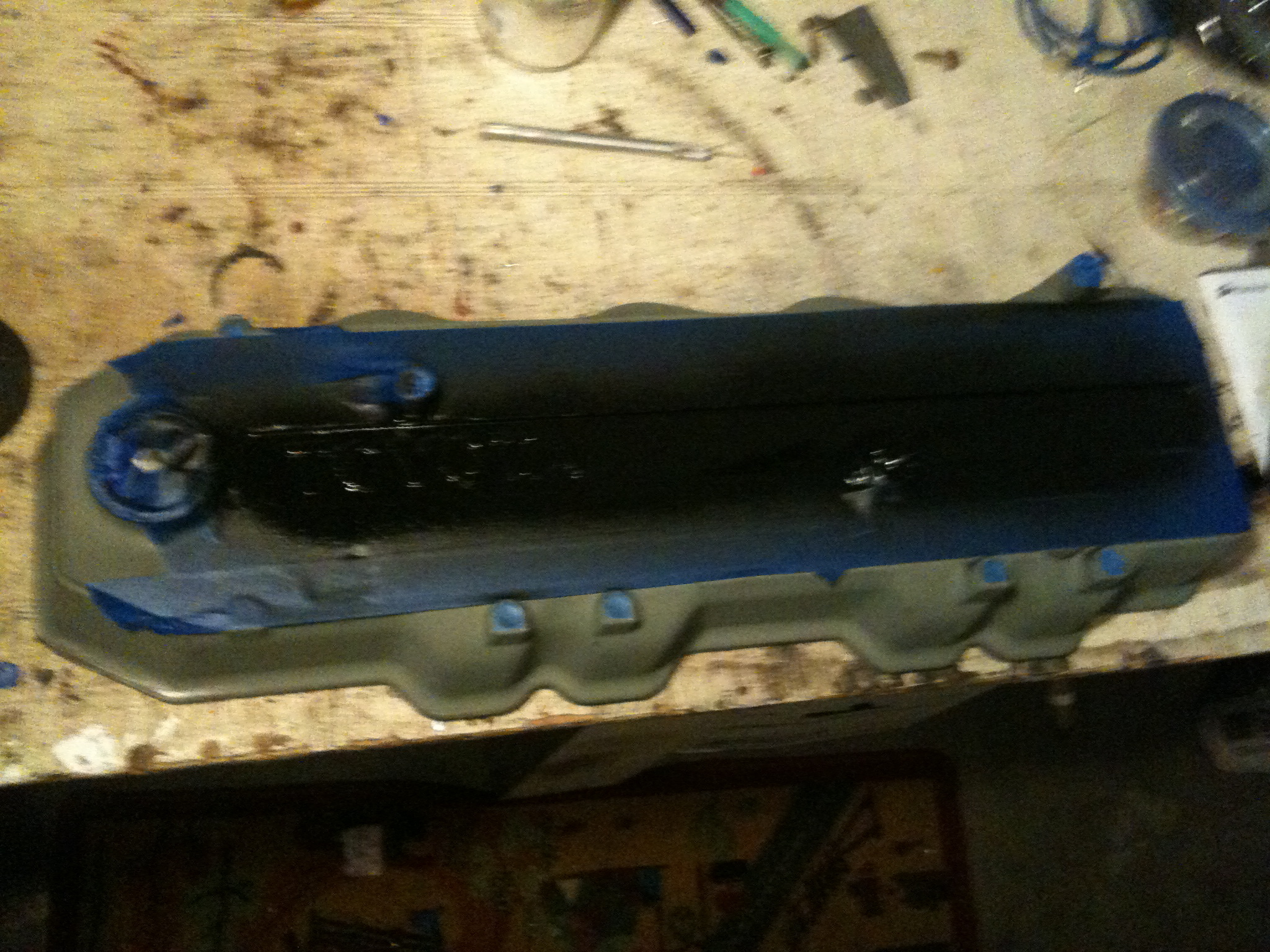

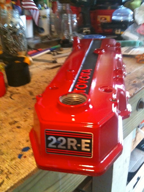

Cover Done...
Got the valve cover done. Just waiting for the new cam, and the re-assembly!
Then it is a short trip to Benny's Muffler Shop, and VAVOOM!
Attached Thumbnails '86 4Runner: Tucker (Tuck)-valve-cover.jpg
