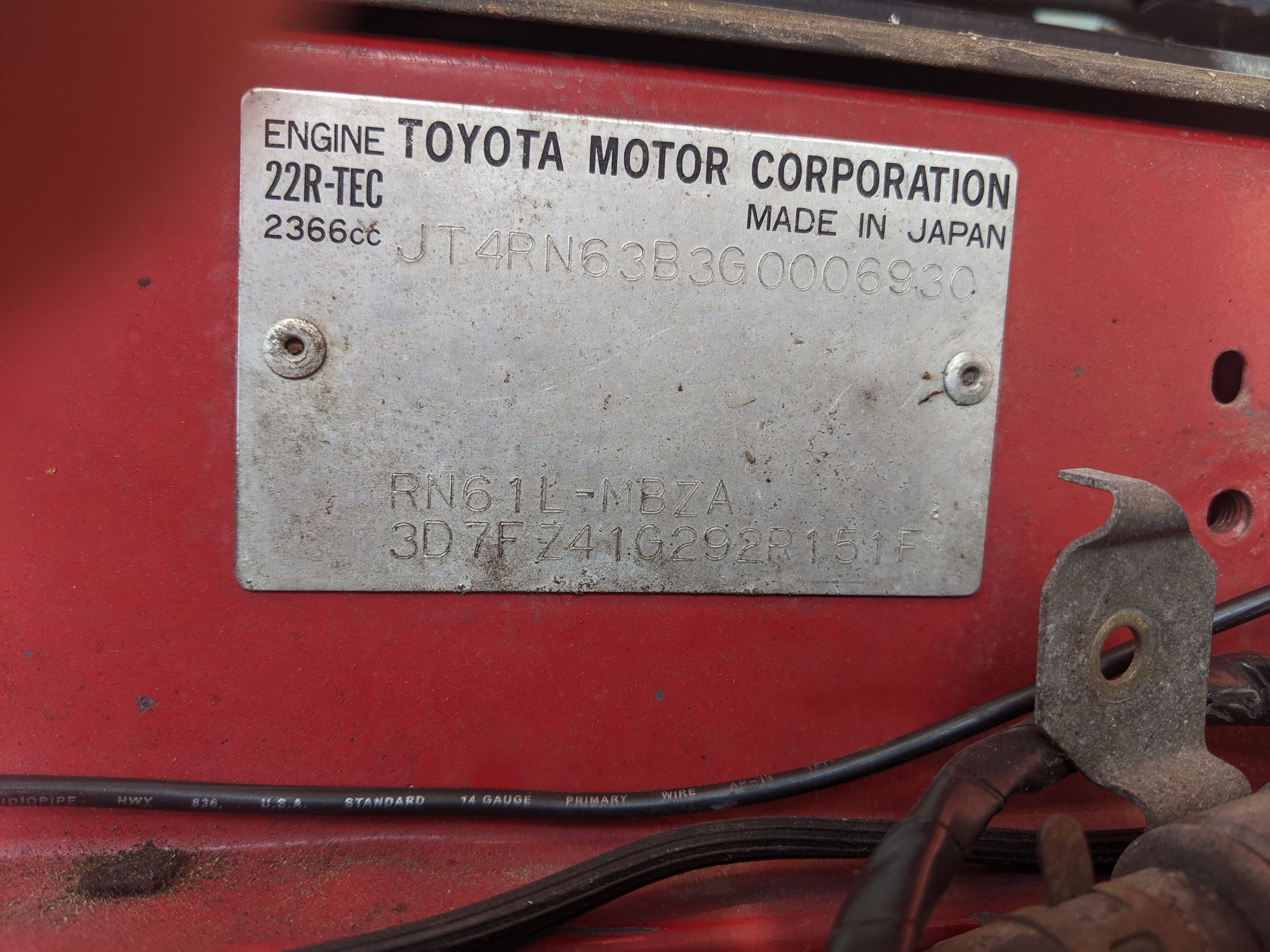

What is the full model number, can look up the computer with that.
Old Oct 16, 2019 | 06:15 AM
  #28
Theyseemespoolin's Avatar
Joined: Apr 2019
Posts: 38
Likes: 6
From: Nashville
Old Oct 16, 2019 | 09:24 AM
  #29
Co_94_PU's Avatar
iTrader: (-1)
Joined: Dec 2012
Posts: 5,433
Likes: 555
From: Colorado
Rn61l-mbza
89661-35050
