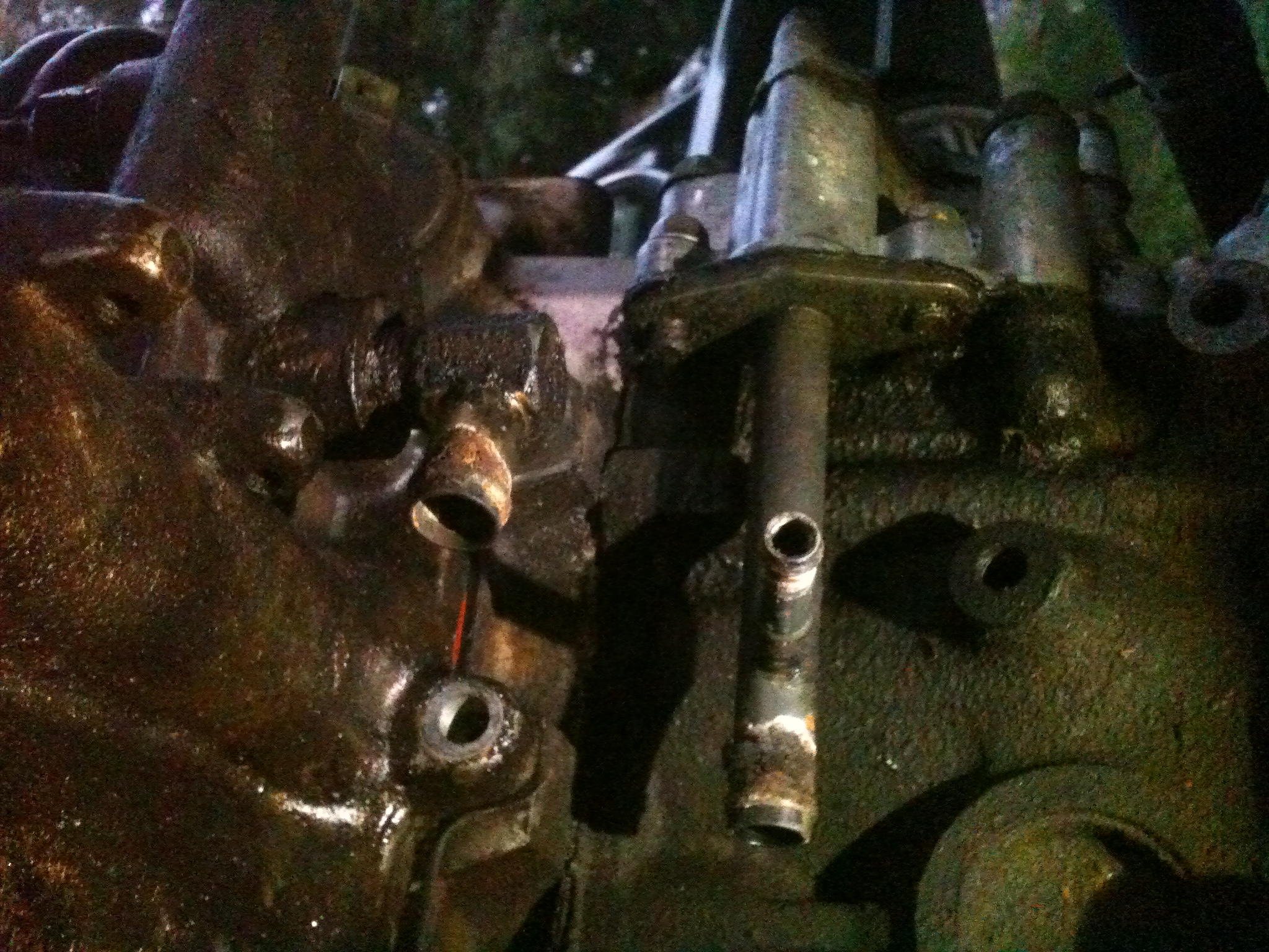

lower intake hose....i cant find where it goes
hey guys im new here not sure how to start a new tread but it goes along with the 84 22re to 90-93 transplant
i have a 1990 pickup that im putting a 1984 celica motor in and i have came across a problem with locating where a hose goes on the lower intake at the front of the motor
i have a few pictures im trying to put up now but the hose is right under the two connectors next to where the thermostat goes
