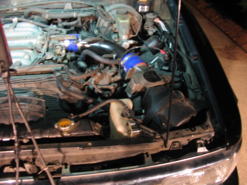

well i finshed it here is what it looks like

That looks great, what airbox is that?

the air box is from a a 90 cerssida same with the afm
the best part about this air box and why i used it it use's the stock k&n filter that i had
i gonna make vid of my truck driven soon and to show the air ratio wheil driven

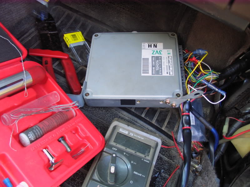

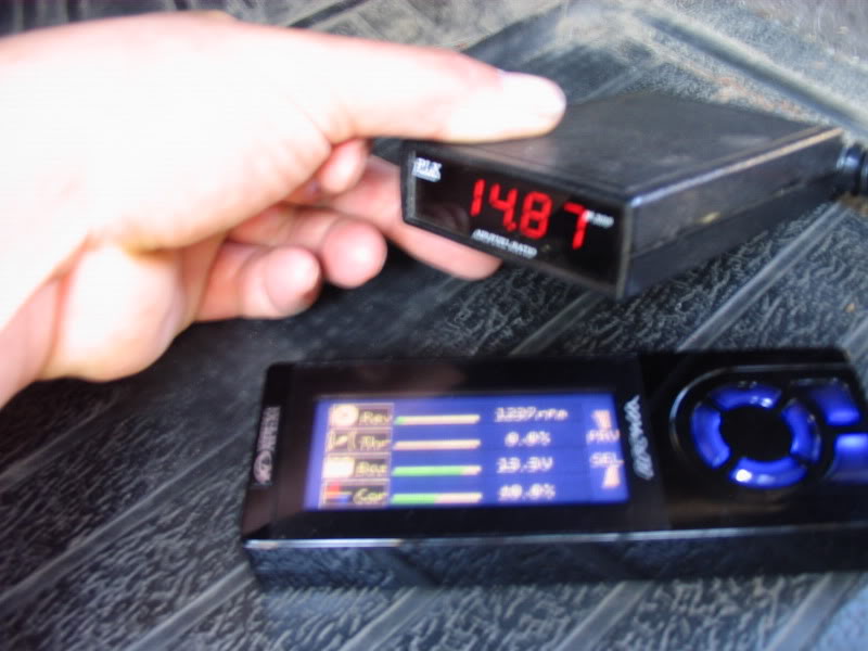

going to do some light tuning tonight but for now here is some pic's
