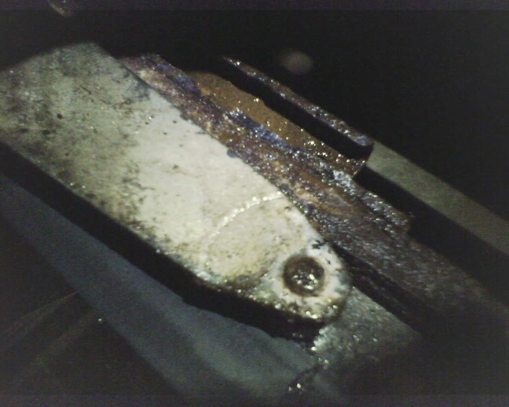

Jump window motor to the battery until rails are in the lowermost and narrowest position and remove regulator. Motor is held in with 3 8mm bolts (or flathead/torx depending on year) on the reverse side, remove these.
Rails are under spring tension, when motor is removed they snap closed so watch for pinching. Remove screws holding top gate trim piece on, door handle (two screws under lever) and lock, remove trim and slide window glass out.

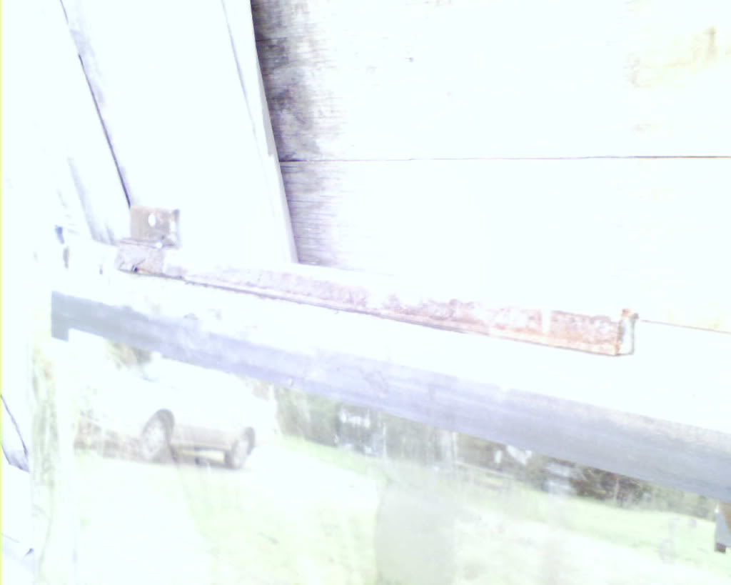

Pass side was OK, chainsaw bar oil to keep it from further rusting.

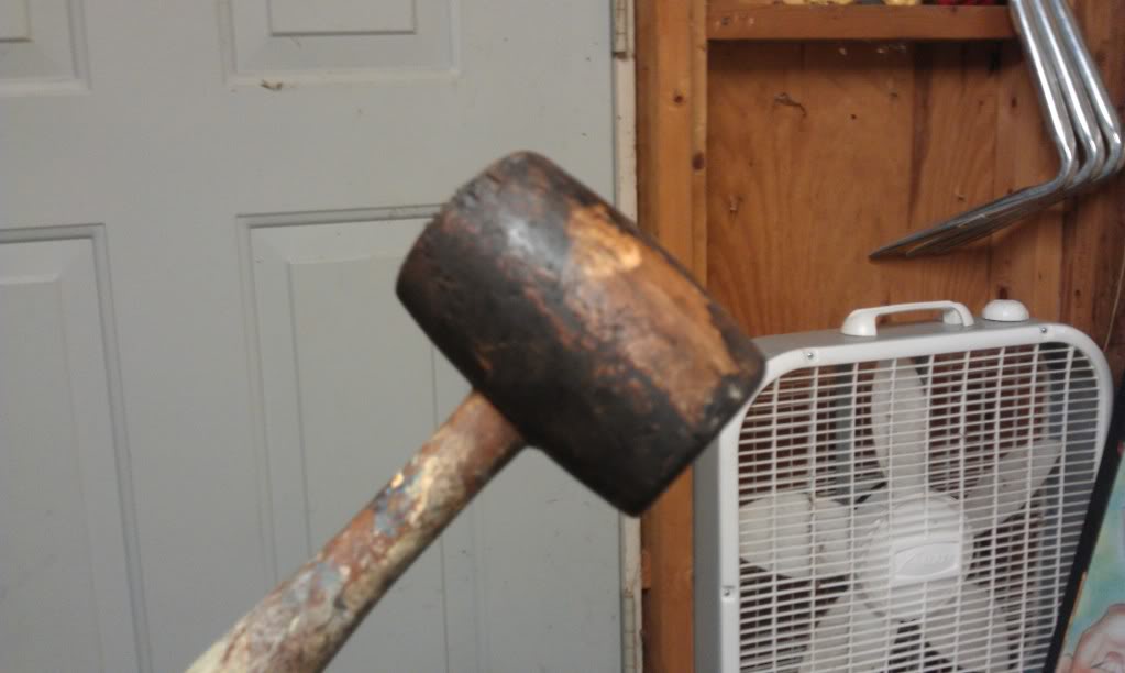

With the glass out, I took a screwdriver and a hammer and tapped (not so gently at times, don't be scared to hit it) the old rubber and brackets off.
I used some windex type cleaner to spray on the rubber and the new brackets, hit them with hammer and they went on nice and easy.
The parts were 60$ Brand new from toyota.
