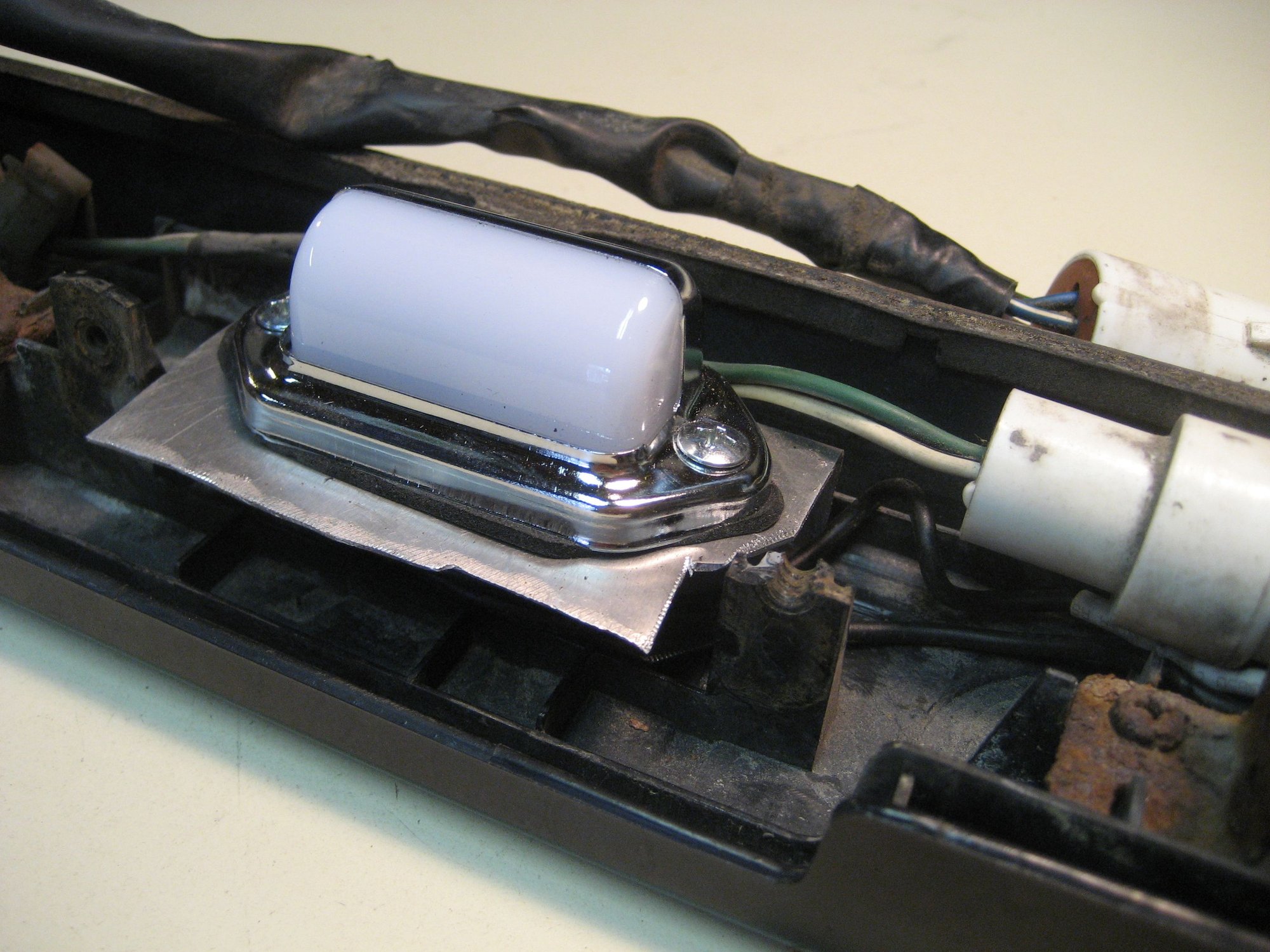

In the end, I had to replace the light fixtures as they were badly corroded -- same as others report. Figuring my incandescent fixtures lasted about 25 years, I opted for another similar set.
This required fabricating a couple adapter plates -- see photos.
Frame above license plate after adding adapter plates
Adapter plate
Adapter plate
New lamp on adapter plate
Finished result
Finished result
See that connector in the middle? Be sure to secure it so it doesn't get in the way of the glass -- there's not much clearance and it'll catch.
This is the replacement light I used.
