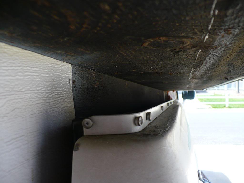

Here's a pic of a side snap-rail. It's partially concealed by the truck camper now. I had to cut off the part where the footman loop goes to get the truck camper to fit, otherwise you'd see that too.

awesome man thank you. this will be very helpful
