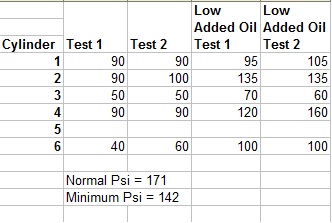

Recently rebuilt the 3vze in my 92 4Runner, but it won't start. After months of on and off fiddling and testing everything possible I decided to test the compression. (Didn't think it could possibly be the compression since it was just completely rebuilt..) The results speak for them self.
The FSM said that it could either be sticking valves or a problem with worn cylinders/rings. I'm pretty sure it isn't the cylinders or rings because I had them bored out and replaced with new pistons and rings. Although, as you can see from the picture, after adding oil upon suggestion from the manual the compression went up on half the cylinders. Still low, and not consistent.
The heads were cleaned and new valve seals were put on by the machinist while having my block bored. (In retrospect I should have had a complete valve job done.. lesson learned!)
So what do you guys think it could be?
If sticking valves, how would you check them and/or fix them?
Could the low compression be due to valve timing? Although I know for a fact that the camshafts are lined up with the crankshaft for the belt timing.
I've done all the work myself besides having the engine machined and would probably try to do the rest myself too. Any advantages taking it to a dealer for a valve tune up?
Didn't test cylinder 5 because it was a pain in the ass to reach and I couldn't connect the compression tester.

3 and 6 are totally unacceptable and the rest are just plain bad for a new bore and pistons. If the valve timing is not off and Since it is a new bore, rings, and pistons, and assuming that you did not put the rings on upside down and you did stagger the ring split on the two rings top different then bottom, I would guess it is the heads. I would pull the heads and have them totally redone. Valves ground and replaced if needed and new guides and seals and resurfaced if needed. Be sure the heads are checked for cracks. If you tear it down I would also Mike the bores to see if the machine shop bored them correctly and mike the pistons to be sure they are correct.

Short, neat, pretty, and sweet. You haven't broken-in the piston rings and cylinder walls. All compression tests are futile in determining the end results of a proper break-in procedure, until it's been completed. And since they're ALWAYS going to be higher if it was done correctly, you're in the clear there.
Why it won't start? Beats me sitting here, it's nothing you're thinking it might be IMO. I'll bet you money I could make it start if I were there though. Mine's never been able to stump me yet. And boy has it tried!
O.k., what's the first thing that's comes to mind from experience. Hmmm....VAFM connected? Probably wouldn't start if somebody left it unplugged. Could be A LOT of things though. Should you have paid for a COMPLETE valve job? NO. Odds are the intake valves and seats could've been lapped and re-used, but replacement of the exhaust valves and seats would've probably been a good idea in the long run. Again, from experience...

MAKE SURE you put the correct shims on the correct valves when the head was reassembled. If not, your valves aren't closing properly.
Also, since the cylinders were honed.....were over-standard size pistons/rings used?

@TNRabbit: That could very well be my problem. I had all the shims lined up and matched with each valve when I took it to the machinist but when I got it back they were all in a big bag.
Edit: Yes, I put .30 over sized pistons/rings in
Either I'm going to play hell trying to figure out which shim goes where or possibly tow it to a dealer
Any idea how much a toyota dealer would charge for valve adjustment/shimming?

Well that's going to be most of all of your issue there man! As for the dealer I donno what they'd charge for that. All I know is that it's going to be a pain in the arse to do.
I'm sure you could do it yourself it's going to be a lot of trial and error that's for sure. Good luck to ya! Maybe have the machinist do it since he mixed them up in the first place.

Even if you were 180 out it would still fire once in a while...You'd get a hit here and there. I'm betting it's the valves.
Just to check spark pull a plug wire and stick a screwdriver in it and hold it against something metal. See a spark you know you have spark.
Even if you do have a spark with the compression being so low, valves being open, you may not get it to hit at all. Get a valve job and start over.

Could also be your heads are warped, #6 is notorious due to the exhaust manifold design. best bet now is to pull you heads off and take / ship to someone who is competant with the engine.
3 & 6 are at the back both heads may just be curling up.
Pull and check with a straight edge and feeler guages, they might even be twisted.

the heads were resurfaced at the machinist and looked over for cracks and what not, and I had no problem with them before. Had a head gasket failure about a year into owning it (going on 7 years now) and its been fine. But I'll make sure to have it checked for warpage. Also I'm pretty sure the 3rd cylinder isn't at the back.
Back
5,6
3,4
1,2
Front

I don't know what to think about your valve shim dilema. Do it yourself with the proper measuring equipment/tools is my suggestion, probably a lot cheaper that way(was for me). And then you know it's done right. But unless some of them are shimmed to the point that they can't close all the way, I don't see how it could cause a compression problem anyways. It certainly isn't going to affect the valve timing much, there's only going to be so much difference in shim thicknesses, and it ain't likely going to be a whole lot. So they might be closer to shimmed correctly than you think. Hell, you don't even know you got it wrong YET! Plus, like I'm saying, I'm pretty sure you'd have to degree the cams to change the valve timing significantly.
I forgot to mention the time I thought I had a burnt #6 exhaust valve(massive compression loss @ #6 cylinder), and it ended up being a cracked #6 piston. That was fun!
