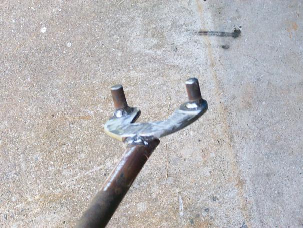

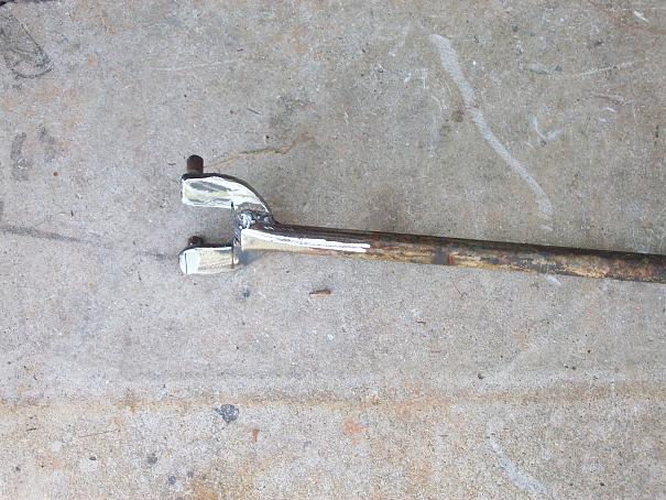

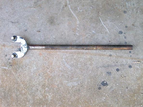

  #119
peapicker's Avatar
Posts: 292
From: Morganton, NC
my answer to toyota's sst
Little bit a scrap metal and about 30 minutes.
