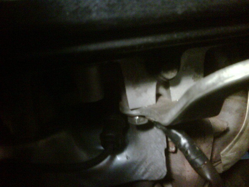

http://www.flickr.com/photos/42357420@N06/7198468254/
Can anyone tell where this is supposed to be attached? I think its a ground wire. It's for a 93 4runner driver side engine compartment and the other end of it runs to the inner fender wall below the coil/ignitor.
thanks for the help.

Fixed the image. I'd have to look. Hopefully someone else will chime in sooner.

Any good ground on the engine should work.
although it does not hurt to clean the ring terminal and bolt.
Then I always put copper Never Seize on all the ground connections:jessica:

that wire bolts on the block behind the alternator IIRC, I think I accessed it thru the wheel well.

Thank you. I will get that done tomorrow. Much appreciated.

Mine is mounted on drivers side engine hook bolt
