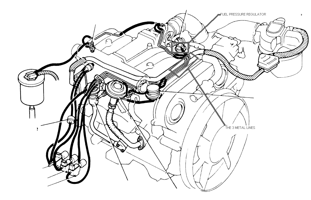

PLEASE SEE THE DIAGRAM....it may explain a couple things
Hopefully the attachment worked...if not, lemme know

ok now what are those 3 metal hose across the top for? and how would i replace those?

One goes to the EGR and I believe one goes to the fuel pressure regulator or fuel pulsation damper. Both important.

Originally Posted by yota addict
Attachment 74895
HMMM i come from jeeps... SO many vacumm lines.. can i replace those with rubber hoses??? doesnt seem to be much suction coming from them. see that pointer box right in front of the fan shroud? that were the lines are rusted off. Going to the passenger side

rubber lines would prolly work...make sure the rubber is pretty thick, tho, or they might collapse.
I agree about the amount of lines....thats good old early emmissions engines for ya

if I remember correctly, all vacuum is introduced into the system on the passenger side, so the suction is being lost at the rust....fixing this may not solve all the problem, but there should be a pretty big improvement...after fixing mine I had to look down at my tach when I stopped at a light just to make sure she was still running
