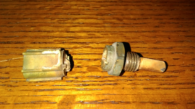

Old Feb 22, 2015 | 05:34 PM
cpljenkins01's Avatar
Joined: Mar 2013
Posts: 168
From: Berkeley county wv
Found out my problem I believe finally coolant temp sensor
Attached Thumbnails 3vze air fuel ratio problems-forumrunner_20150222_213407.png
Old Feb 22, 2015 | 06:07 PM
skypilot's Avatar
Joined: Sep 2010
Posts: 1,151
Likes: 6
From: Peekskill, NY
Ahhhhh.... The sensor on the back of the block! Glad you found it! Those are a notorious point of failure.
