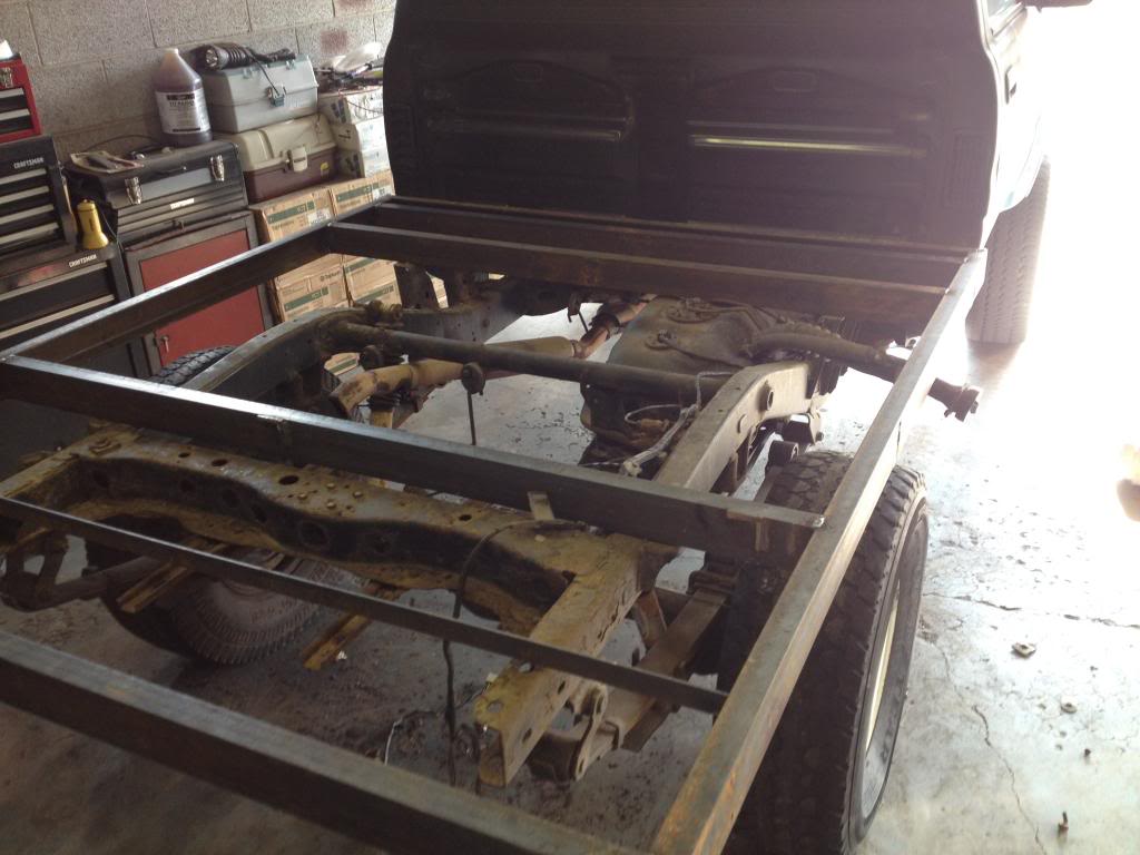

The main frame cross members and headache rack is made from 3x1.25" channel, and the deck is made from 11 gauge steel, close to 1/8" thick. I had the ends of the main frame rails cut to a 45 degree angle at work. The channel I used weighs 4.1lbs per foot and the sheet weighs 4.1lbs per square foot. I got all the steel from the scrap bin at work for $36. And the weight is accurate because we buy it by the pound. The whole bed weighs between 395-405lbs give or take.

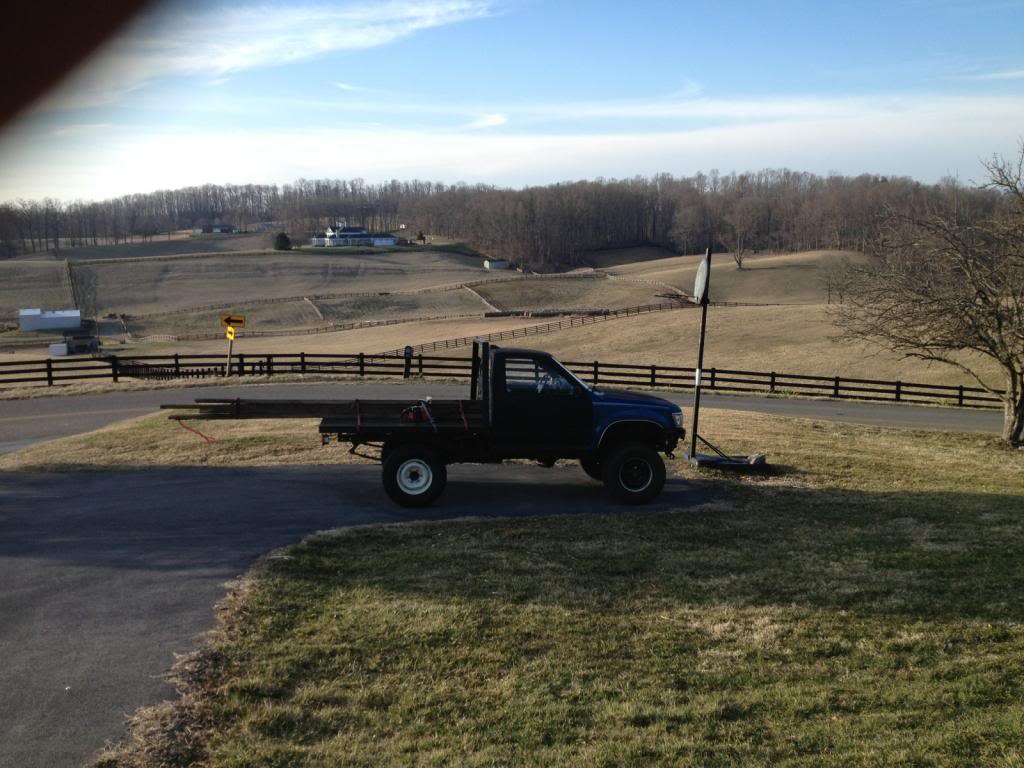

Old bed off

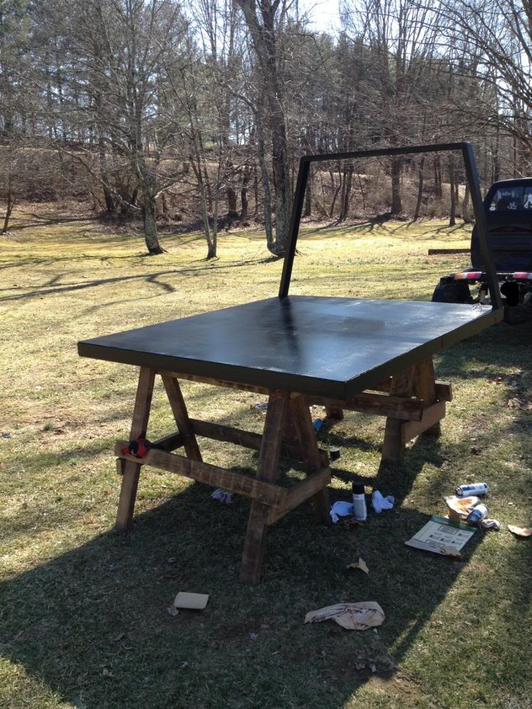

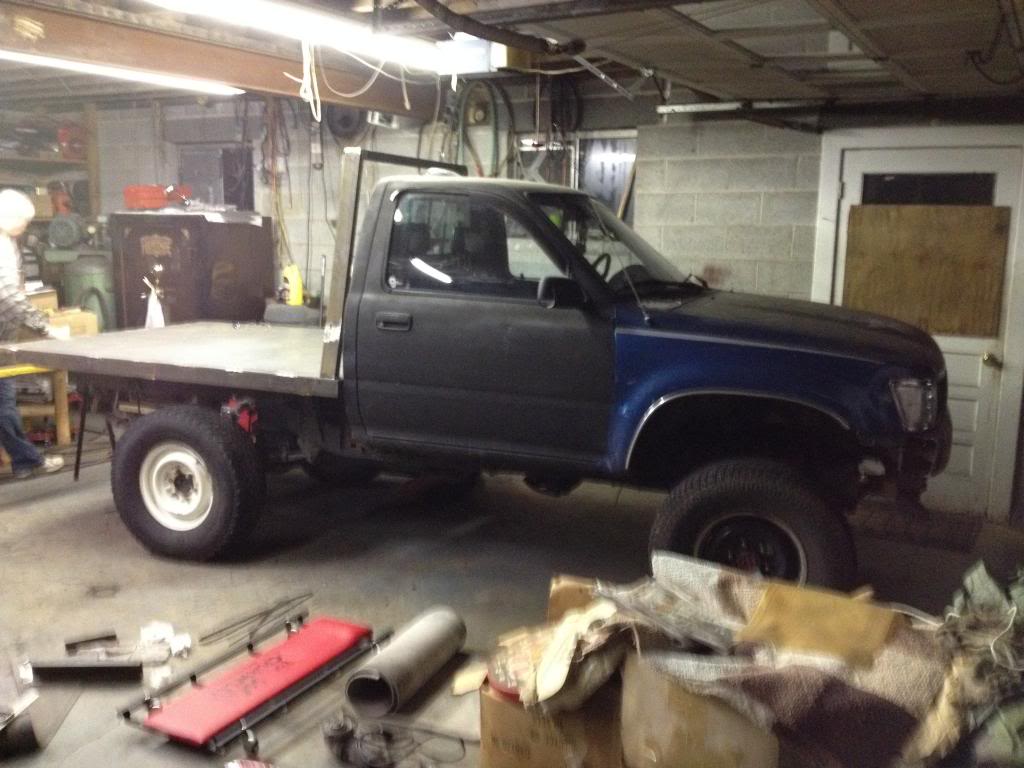

Deck of flat bed before mounting it

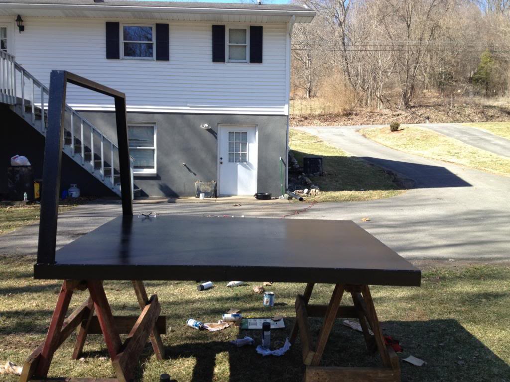

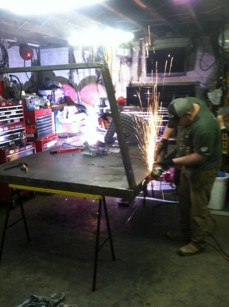

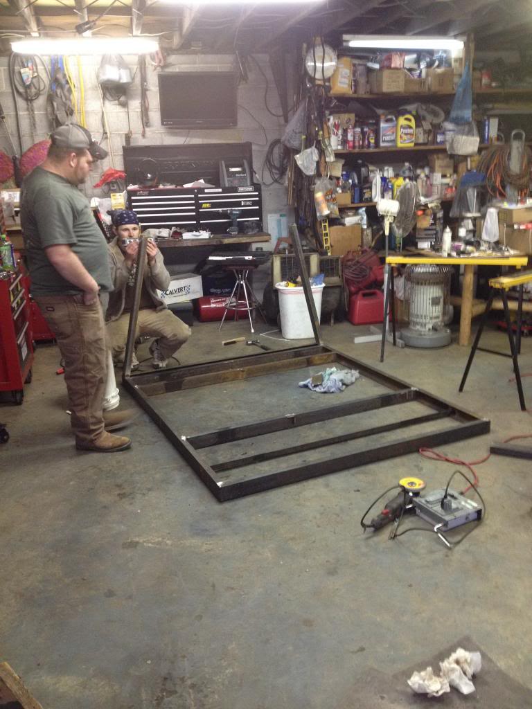

headache rack mock up. Guy doing the measuring is the mathematician of us 3. Guy watching is the muscle

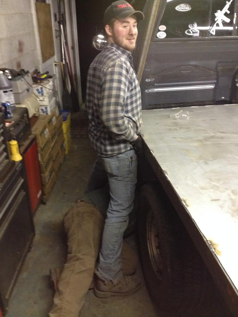

Me tacking the deck on, muscle doin some grinding
Me in an awkward but must be done that way team work moment

Finished
All of this was welded using 7018 rods and 225A Lincoln ARC welder. Where not master fabricators by any means, but we all went to college together in the same program and had to take welding so the beads aint the prettiest, but there strong and penetrated good, so im happy.

Looks like your rear tires may rub with a load..maybe not

Also curious about the rear wheels hitting the bed. Lets see some flex shots!

No flex shots yet. I'm not really worried about the tires hitting the bed. I had 600lbs on it the other day and it squatted some but not nearly enough to make contact. It may with a good load but I don't. Think it will like it is but I could be wrong. I talked to a guy n town the other day that had a Toyota with a flatbed but he didn't put any spacers between the frame and bed like I did and he had a riding mower on the bed and a few tools and he was close to hitting but not enough to bottom out over a bump or anything. I guess time will tell

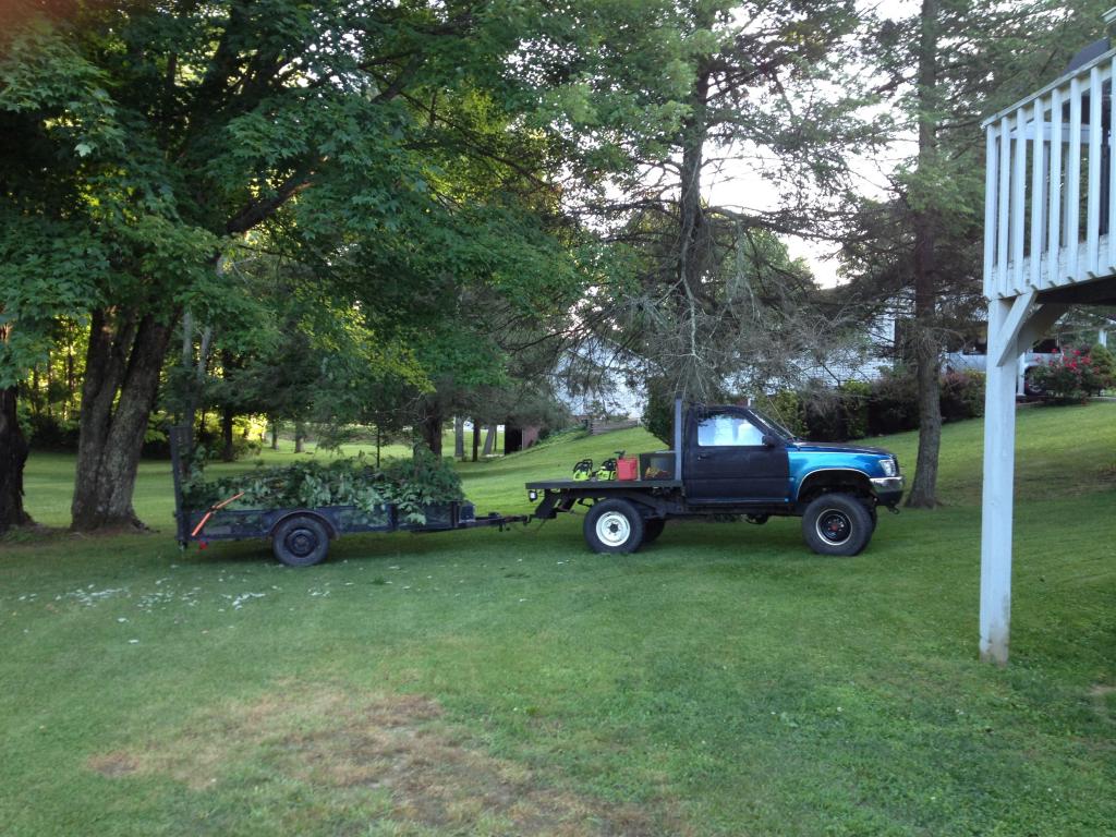

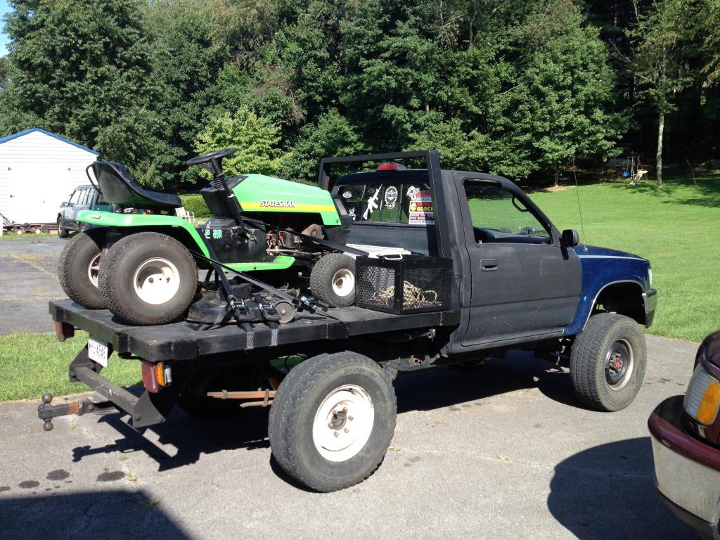

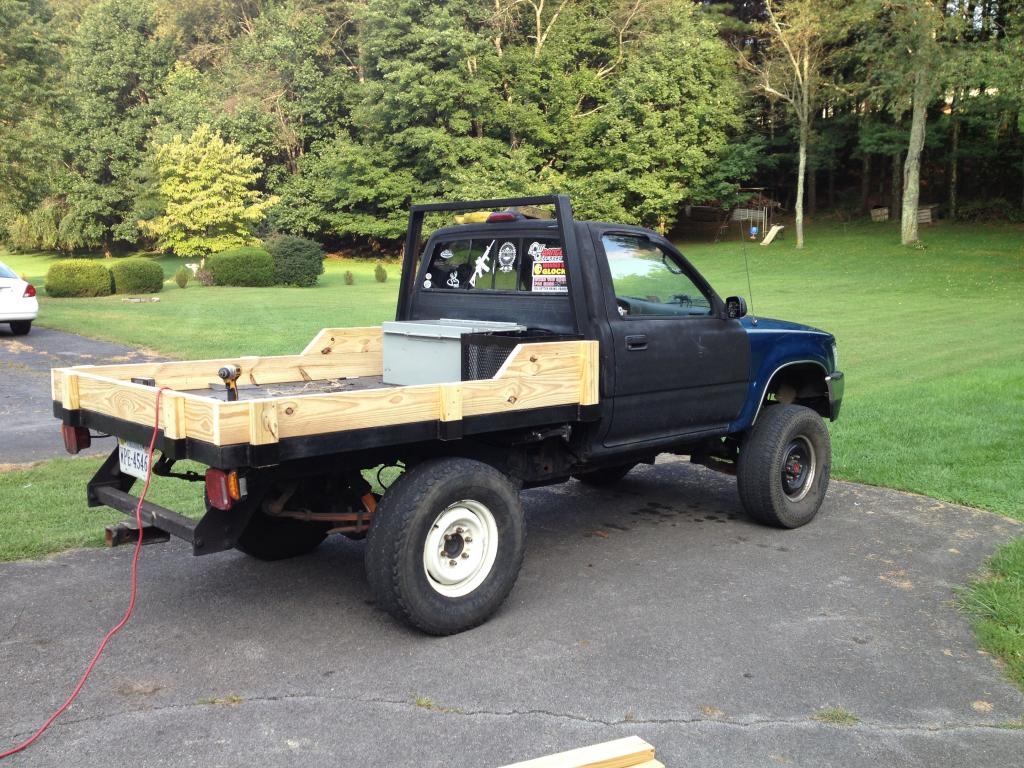

Got my stake pockets on and 2x6s around the deck. Still Ain't finished the headache rack or back. Also put a hitch on it, tool box and crate. Super handy. Gonna get some flat bar from work and go all the way around the the stake pockets so I can tie down at any point
Doin a little work before the bed sides
