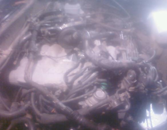

Well I strarted to pull my 3.0 on my 1992 truck with an automatic. I pulled wire harness to find that one set of wires was cut and I cant find other half and would like a little help. Here is a description and a picture of them (wht/red 16ga, pink/green 18ga, brown 18ga, and Black 12ga which has a ground shield with another black wire inside it. almost like a coax except copper strands) these group of wires were streched almost to end of tranny. I hope that is not confusing and I know my picture sucks but I only had camera on my phone. I also found that my O2 sensor back by tranny is not connected to anything and cant find those wires. Here is a little history I bought truck from an friend who did a cheap engine swap on it already I got for hella cheap it ran for about 4months then engine blown up again. This is how I recieved truck blown engine. Any suggestions on wires would be awesome. Also I have toy service manual but not the toy elec manual should I order that? oh and here is another picture of engine so far.. Ha I got to get a better camera...LOL Thanks for the tip on 3' ext to remove engine from tranny these are kind of tips book dont have. I am doing this job alone as of now everyone that said they would help will show up like a calous after the work is done.! ha

in the FSM it should have the wiring diagram, otherwise its a good thing to have! ou can find it online easily, faster and cheaper then ordering it...Does the O2 sensor have a pig tail with plug coming off it or is it just bare?

I have volume 1 of FSM but it doesn't have wire diag. must be in vol 2... But yes pig tail is on 02 sensor. but those other wires I sent pic of they were bare and just tucked up under tranny I thought they might go to 02 but dif color. Silvertruck where can I get wire diag online? Here?

Both O2 sensor wires should have a white/red and a brown for the heater section. The front O2 is pink/green and black for the signal. The rear is red/green and white for the signal wire. I can't make out the colors in your pic so... >shrug<

Sounds like whoever swapped the engine didn't feel like reconnecting the rear O2 sensor, or accidentally cut the wires. Not having a CA 4runner, I don't have the rear O2, so I haven't seen where the wires are routed or join the main harness, but I'm sure if you follow the front O2 sensor wires you will find where the other wires are or are supposed to be.
