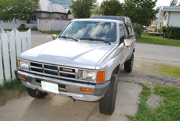

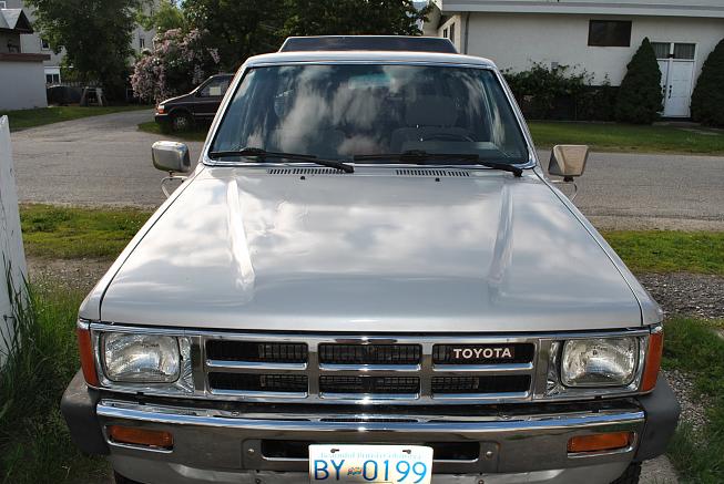

86 22rtec pics!
Thanks Hadmatt54!
I have a lot of work ahead of me. At least its nice to look at...
Here are some pics of my truck - more work needed!

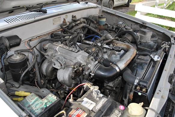

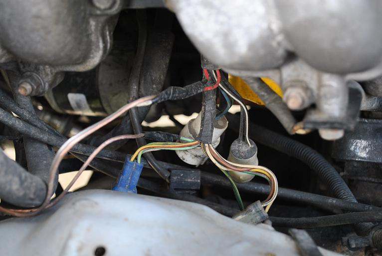

Notice the funky wiring? I have a hunch the PO when he swapped the 22rte into the truck didn't use an rte wiring harness... maybe he canabalized the 22re adding bits and not using others..
Ill post more pics of the wiring and stuff soon. Went to start it today and now to top it off, it won't start. Lots of power I think its a starter or the connection....
Attached Thumbnails 22rte dying...?-22rte1.jpg   22rte dying...?-22rte2.jpg   22rte dying...?-22rte3.jpg

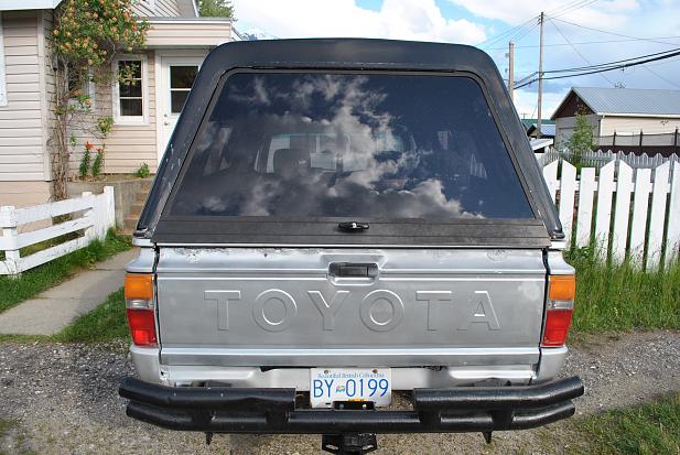

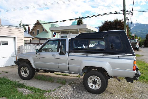

more pics
more pics...
Attached Thumbnails 22rte dying...?-22rte4.jpg   22rte dying...?-22rte5.jpg   22rte dying...?-22rte6.jpg

and more pics
and more pics,..
Attached Thumbnails 22rte dying...?-22rte7.jpg   22rte dying...?-22rte8.jpg   22rte dying...?-22rte9.jpg
