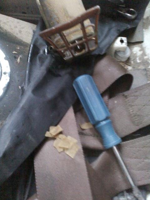

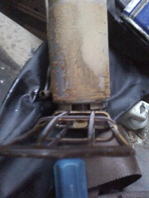

I think I might have found the problem. It looks like my fuel strainer disintegrated and clogged the fuel pump. I'll install a new strainer tomorrow and see what it does. I attached pictures. In the second picture you'll can see some of the strainer which clogged the port. That's about half of what came out of it.
