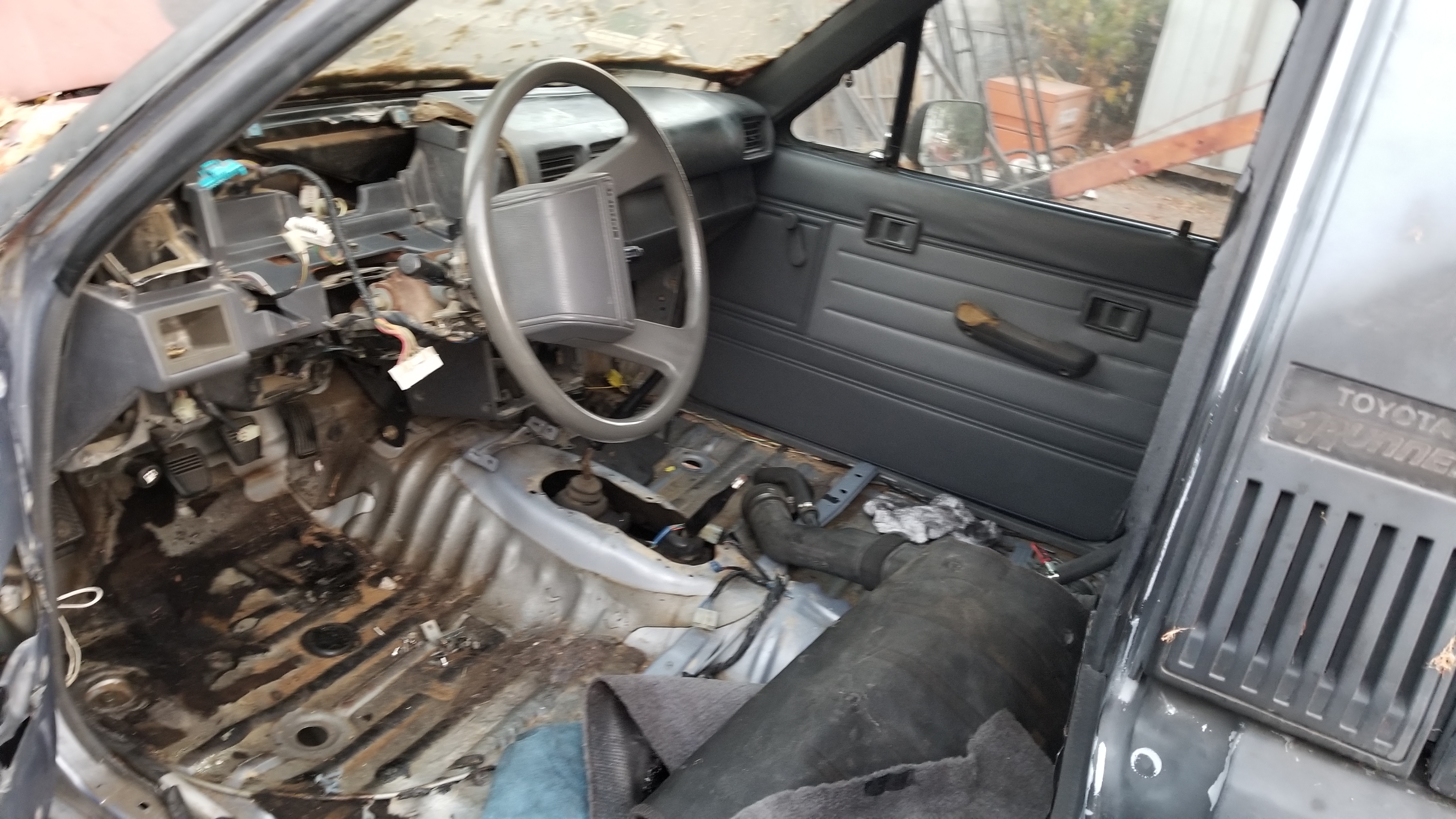

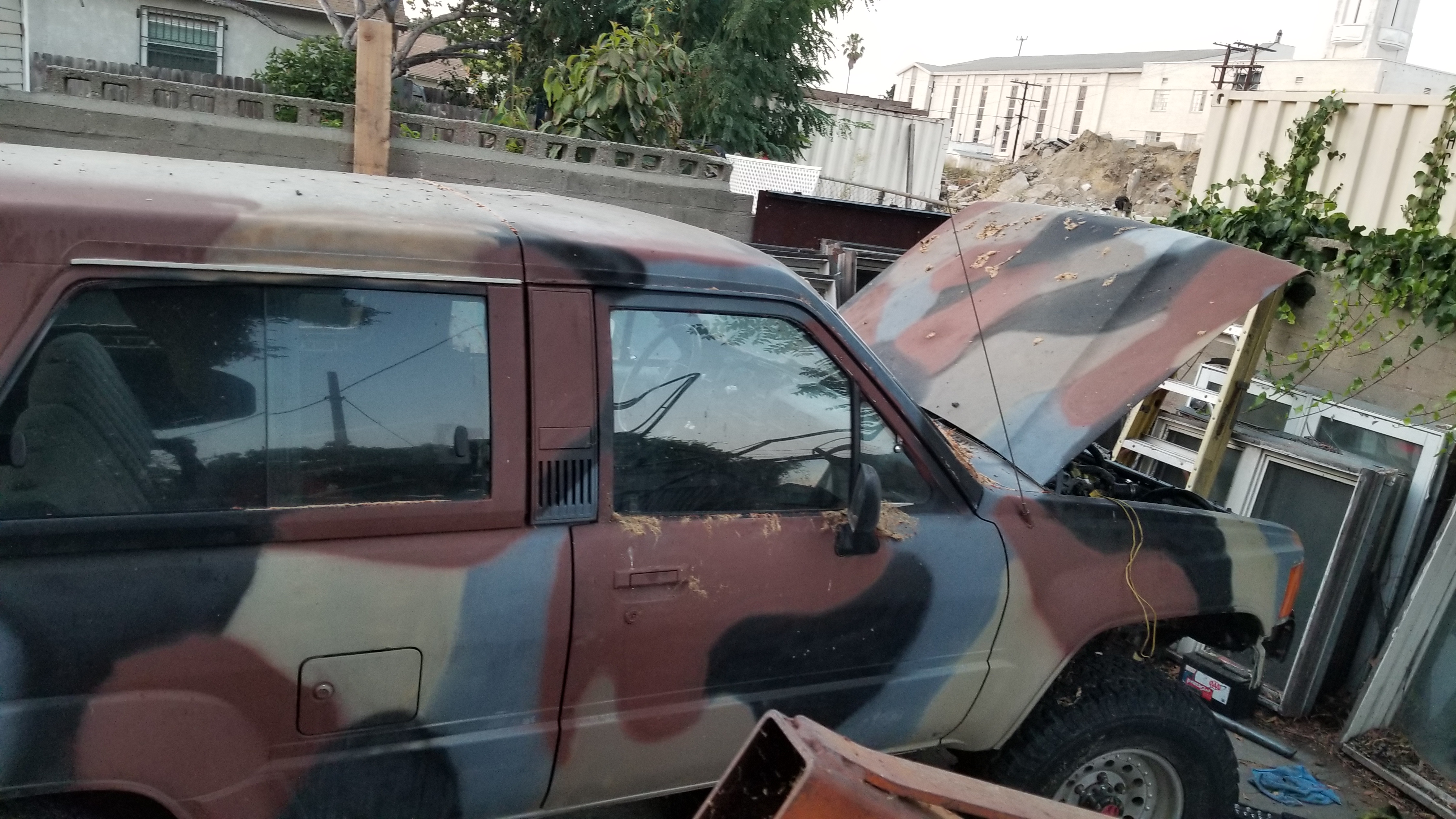

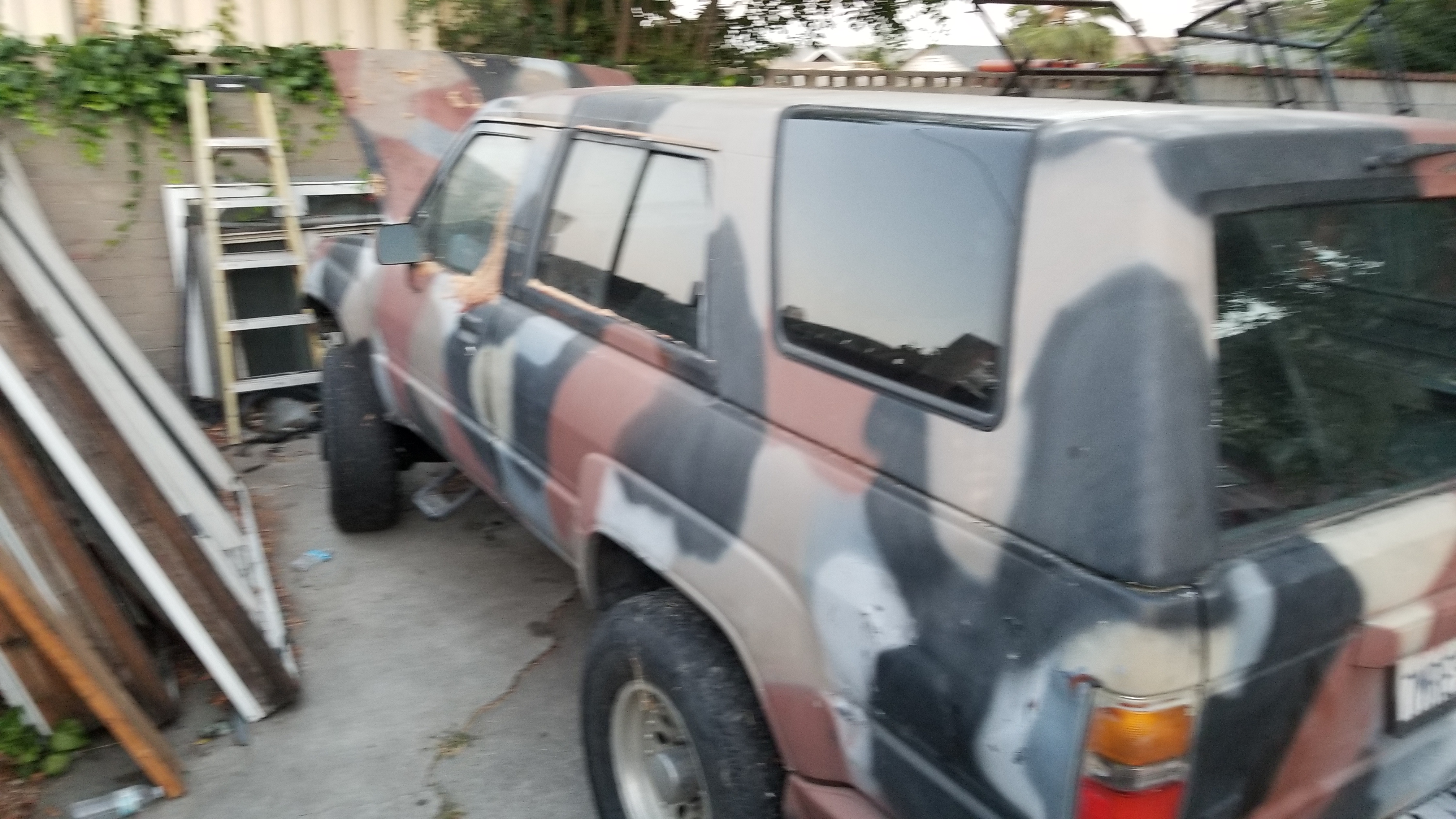

So here is my piece of junk guys . I started gutting it before I took the pics but you aren't missing anything good. I never liked 4runners and I bought this one for parts but after thinking about . I thought it would be sick to have a 4runner to take on adventures . Problem is it looks like crap but that's okay because that's my specialty . What isn't is engines .currently sitting in the bay is an ol rod knocking 22re. Now I have anotjer 22re that SUPPOSEDLY works. But I was thinking why not rebuild this one? Could be fun . I've never done a rebuild but I love learning more than what I already know . So if anyone has any tips , let's hear em! P.S of course I could pay someone to do it but that's no fun!
