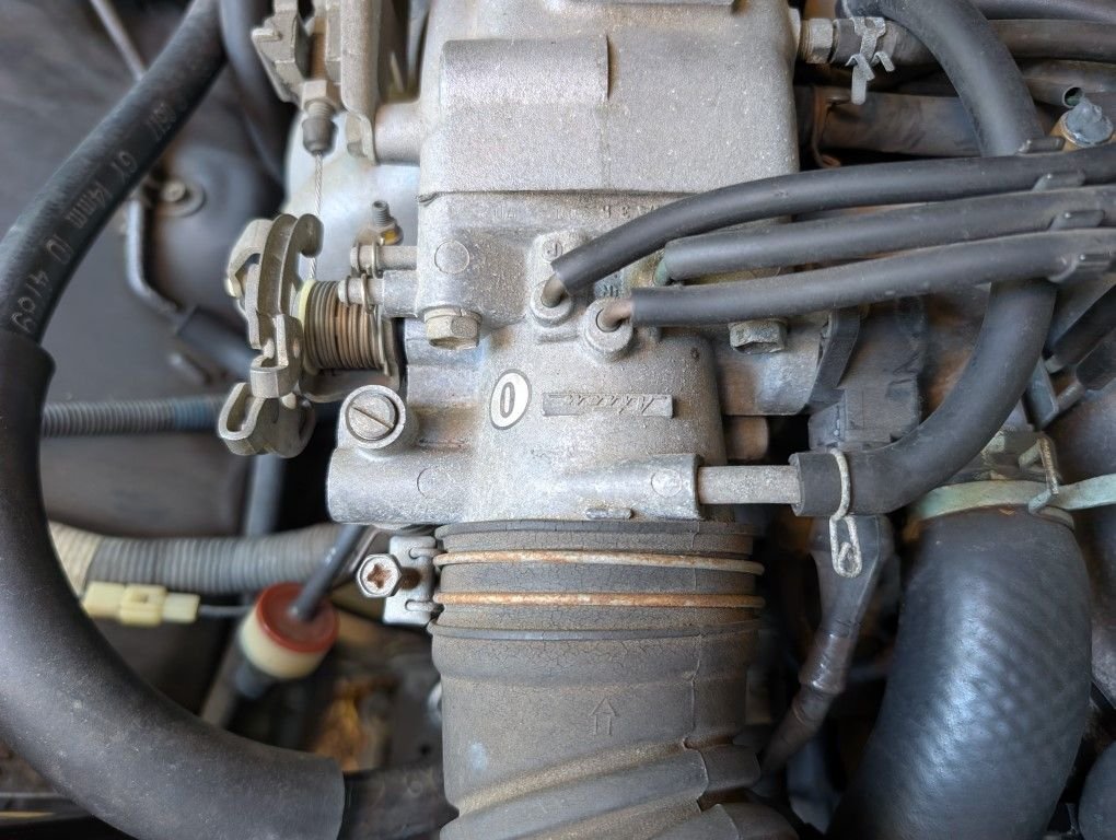

Easy fix: Clean the throttle body and all was better. It cleaned up well with Goof-Off and a paper towel.
Throttle body
Throttle body
After cleaning
After cleaning

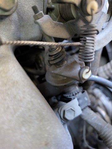

An easy diagnosis was to pull the one-way valve & hose off the dashpot that keeps the throttle from slamming shut too quickly. Without the dashpot, a blip of the throttle would bring the idle back down -- there was enough momentum to crush the gook in the throttle body. After cleaning, it worked fine with the dashpot fully connected.
Dashpot
Dashpot
PS: Anyone know the part number for the dashpot? The bellows is torn on mine, and I expect it to fail in time without the dirt protection.
