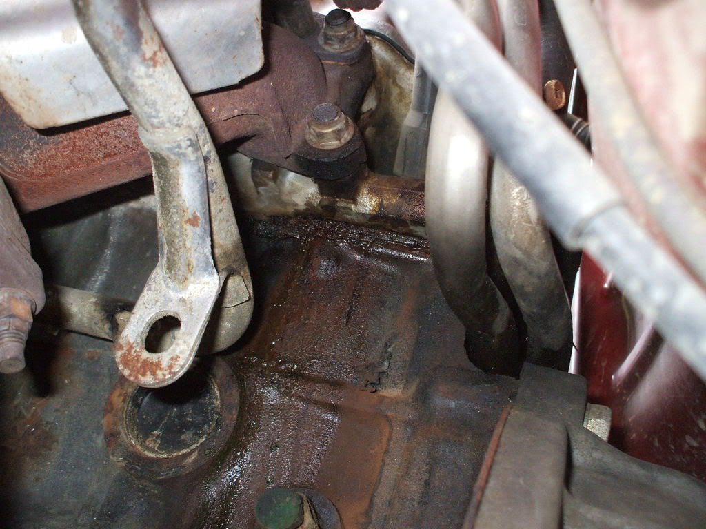

I spent last weekend redoing the timing cover gaskets and such. Just bought my 86 4runner and it leaked like a sun of a gun and there was silicone oozing out the bottom corner of the timing cover so I figured that was the main problem. Left the head and pan on. Went fairly smoothly for my first time. Then I discovered a big problem! Whoever did the timing before I bought it crumpled the head gasket!! It seems to be a good seal between the block and the head but the extension between the head and the timing cover was buggered up bad. I knew I wouldn't be able to save that so I cut it off as close to the block as I could and used lots of Permatex Ultra Blue. After I got it put together enough to fire up I noticed it leaking from one of the corners where I cut the head gasket. I'm going now to putts with it and see if it is still leaking (it most likely is) and if so I thought of taking the timing cover off again and cutting a cork gasket to mate up to the head gasket and again using a liberal amount of Permatex.
I really don't want to take the head off because it seems to be a good seal between the head and the block and I dont have very much money, I'm just finishing school and I'm broke for probably another month until I can get back to work and I know that if I start something like that there is going to be a million things go wrong and I just can't deal with that right now.
Do you guys have any suggestions or ideas?
