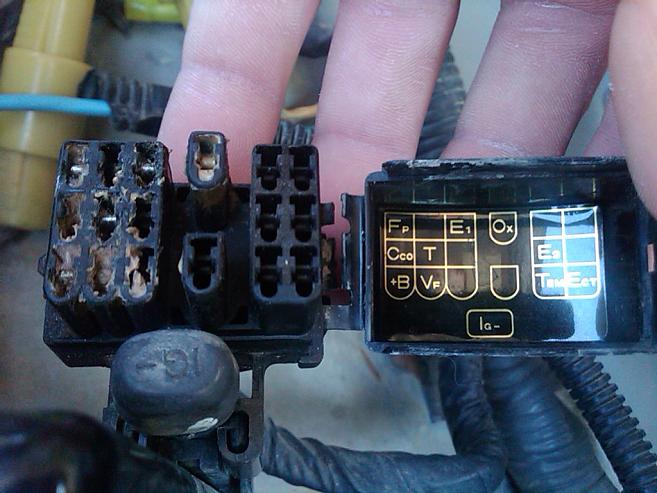

I'd take it apart one more time. use new o rings and cushions. if there is pintle caps on the injectors make sure the notch goes in the groove on the intake manifold... or you could ditch the caps all together. use plenty of grease on the orings before re installing such as high temp brake caliper grease. gasoline is supposedly what is supposed to be used but a light coat of this type of grease wont hurt. after all the bolts holding the fuel rail are on and the fuel lines are hooked up, connect the battery, turn the ignition on and locate the diagnostic port in the engine bay. use a paperclip and jump terminals B+ to Fp. this will fully pressurize the system without having to re assemble everything and run the engine. if its gonna leak it will. if it does leak. pull off the rail and check the injector oring and use a new one...try again..hope this helps

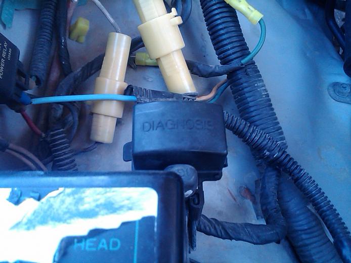

Ill post a pic of what it looks like in a few min.

this is what ur looking for

According to the FSM and your pics, it should be right next to the fuse panel in the engine compartment, but having pulled and rebuilt this motor, I have not seen any such animal. I've traced every wire and can't find it, unless it's under the chassis somewhere. Here's a pic of the space where it should be. Any ideas where else to look? Maybe the previous owner yanked it? I know this truck's been rebuilt before; that's why I had to replace the head and have the cylinders honed. The head that was on it before had been resurfaced down below the min. height requirements, messing up the timing...
