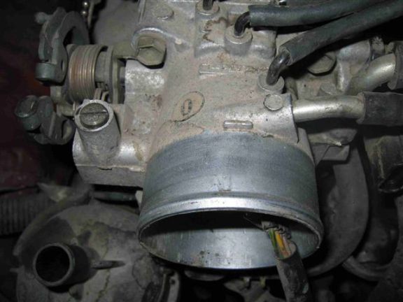

While I was working on the truck I noticed the screw located in what I thought at the time was a hose nipple (located on the top left of the throttle body). Thinking at the time that the screw was a plug to block this unused "hose nipple", I determined to tighten it down to make sure it did not come loose. Now I am fairly certain that this is a valve of some sort. Could this be the source of my problems? Is so, should I still follow the procedure to adjust the TPS in the website above?

Before you change anything else, back that screw back out and see if it runs better.

I tried to move it back using a picture that I took at the beginning of this job. That actually did not work. I have attached a picture of the throttle body. The screw I mistakenly adjusted is on the left of the picture. It is a flat head.
thats the idle speed adjustment, turn it out to increase rpm, turn in to reduce rpm

Thanks. So would this have any effect on the adjustment of the TPS? (in other words, would you still adjust the TPS as described in the website above?)

no, the air idle adjustment screw has no effect on the tps adjustment. the tps could be your problem but i doubt it. it definately should be checked. my truck will still run with the tps unhooked. did you ever mess with the tps to begin with?
