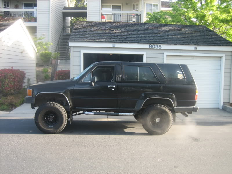

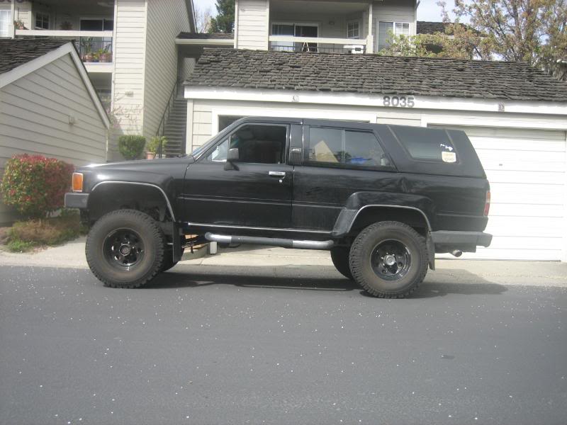

I finally got around to adjusting the T bars on this guy to try and level out the front. Never done it before. From what I understand, there was to be a lock nut atop the adjusting nut. I found the locknut on the pass side, but the driver side DIDN'T HAVE ONE!! Is this bad? I cna thank Big O tires for losing this years ago I believe, since they installed the lift kit....and had forgotten to adjust the T bars (the IFS was riding on the frame for a bit...).
Anyway, I adjusted the nut on the T bars 3/4" on both sides, and got about an inch of drop (from fender to wheel rim) it looks like.
Here are some progress pics:

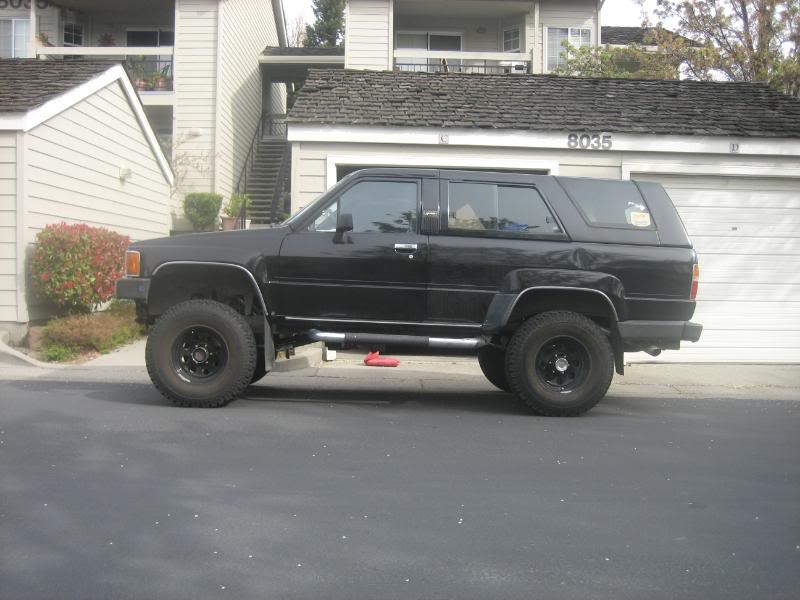

Before the ZUK Coil mod (rear riding about an inch off the bumpstops with 4" blocks; 4" IFS lift):
After the ZUK Coil mod (4" rear blocks GONE!):
After adjusting the Torsion Bars this weekend (dropped about an inch up front to even out):

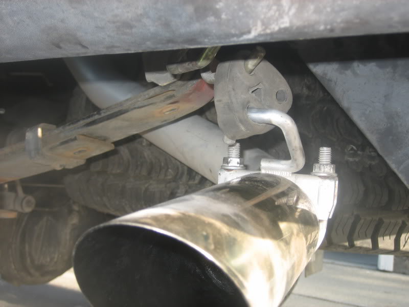

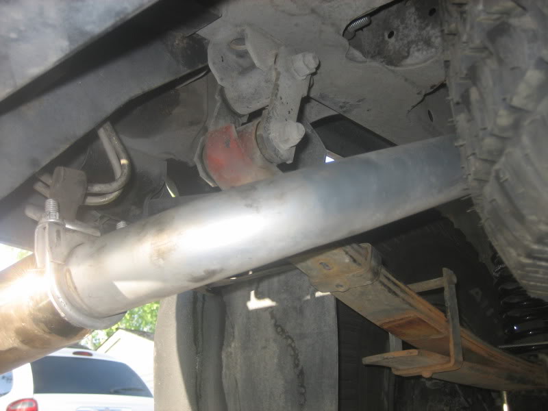

Now all I need to do is figure out my exhuast - I thought I was going to have to relocate it to accommodate longer shackles (due to the issue with the ride heights), and it has slip joints, so it's rattly and stinky...need to get it welded. It also buts right up against my spare tire (and sometimes pass side rear leaf) - is this normal (it's not OEM size - it's 32" I believe)?
Notice the ghetto use of the OEM hanger (I actually screweed it into a part of the frame that's about 2 inches farther back than the stock location):
You can see how precarious it is:

Hey Phil. The uncrank looks good. Pretty close to level. Thinking about your exhaust/shackle deal. I know you cut your exhaust to get it to fit, I did as well, Mostly bc the hanger near the exhaust tip wouldn't work otherwise.
I had to get my slip joints welded (they leaked pretty bad, even though I used sealant in the slip joints during assembly. If you decide to do it, have them extend the rear hanger or just lengthen it so you can lengthen the exhaust as far as you can in order clearance the longer shackles.
As for the spare problem, I have a stock size spare, mine doesn't touch, but its close. I am sure it'll get a little more snug when I finally pick up a full size spare.
Lookin good.
Lookin good.
thanks Jason!
I definitely need to get it welded. Right now, with this setup from yesterday, it's bumping up against the driver side rear storage area (above axle, in front of spare) and making some vibrations at certain RPMs. Is lengthening a hanger a big deal - do they just cut, splice and weld? Trying to get an idea of the cost of having this done and the slip joints.

Geez, never even thought about it until I looked at your post this morning. I have no idea what the cost would be. I just ran out and checked my rig, the bend over the axle sits by a little welded on square piece, and I have about a half inch clearance or so, and have never had problems with bumping.
I figure they could add a piece onto the hanger, or just get you a longer hanger so the tip will be the same height, but the hanger on the exhaust pipe reaches forward to connect to the body.
I stopped by a local mufler shop and they said it would be about $40-50 to weld the 3 slip joints.
Also, I stopped by Auto Store today and picked up some generic aftermarket muffler hanger extensions, which I'll try out soon.
I did seafoam today too, so my truck is extra stinky with the exhuast leaks!
