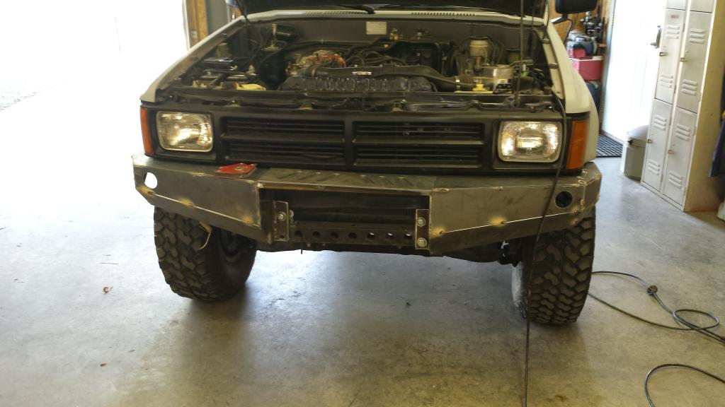

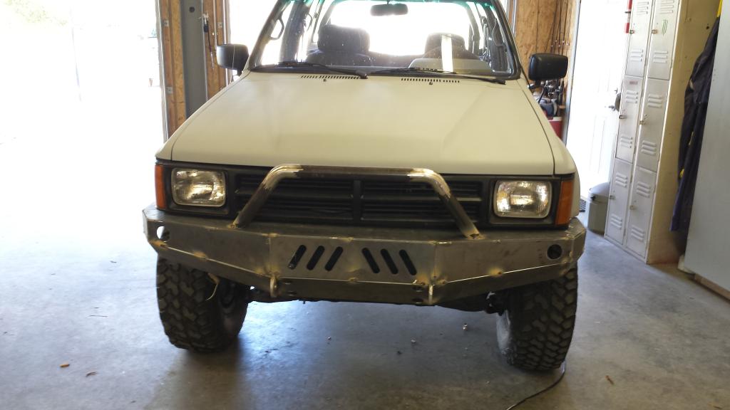

Old Oct 8, 2014 | 09:19 AM
1quickbabydill's Avatar
Joined: Sep 2009
Posts: 96
From: fayetteville,Tn

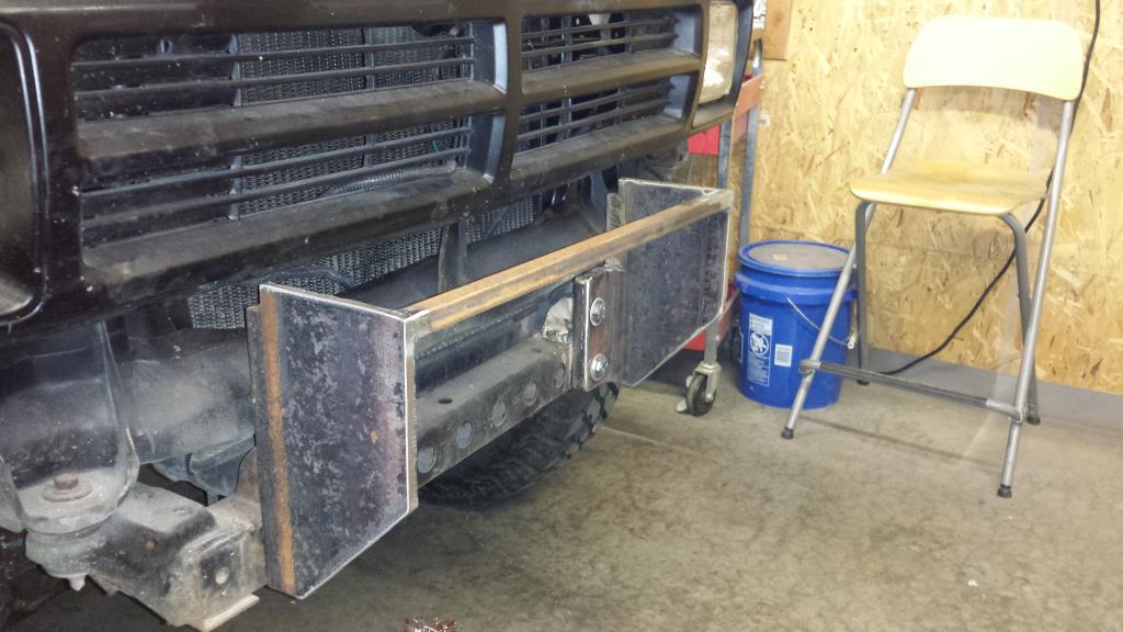

Old Oct 8, 2014 | 10:03 AM
Joined: Sep 2009
Posts: 96

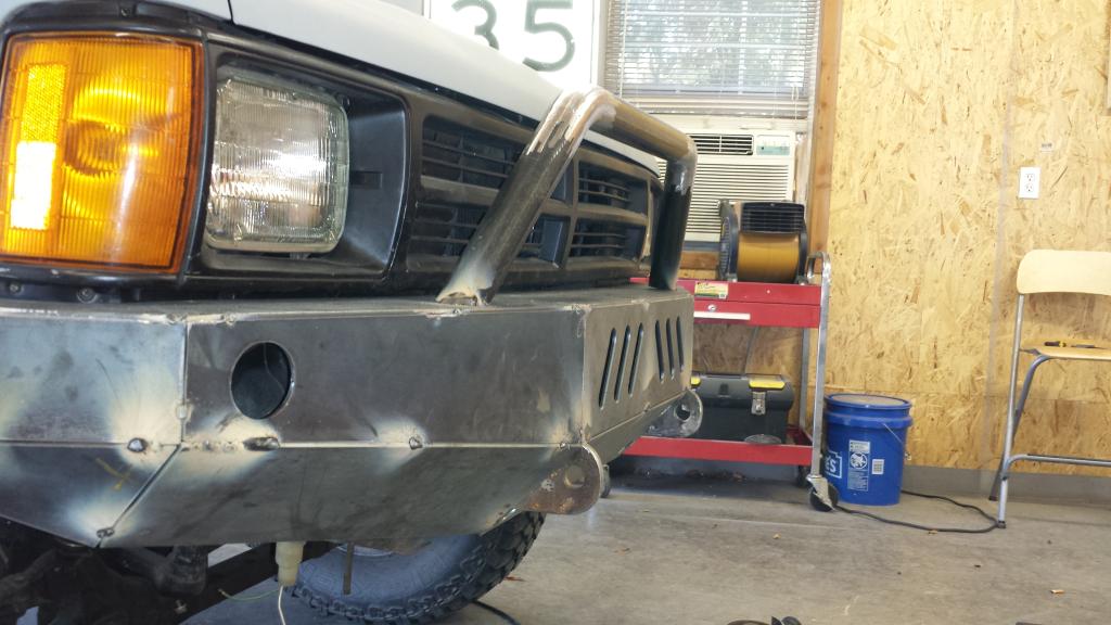

Old Oct 8, 2014 | 12:03 PM
Joined: Sep 2009
Posts: 96

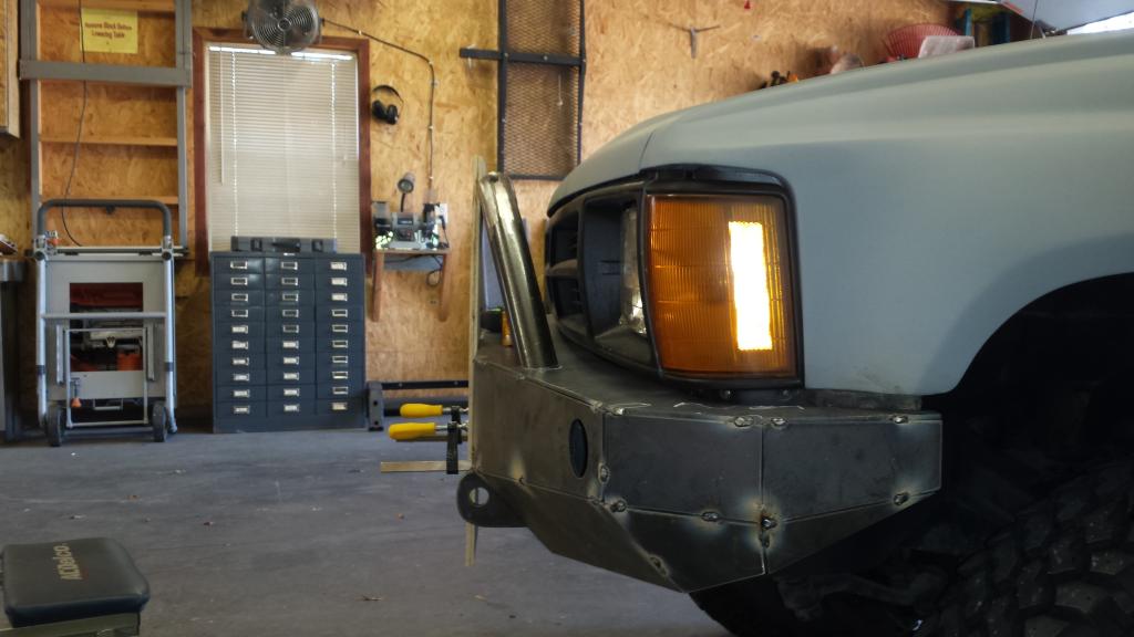

Old Oct 8, 2014 | 12:05 PM
Joined: Sep 2009
Posts: 96

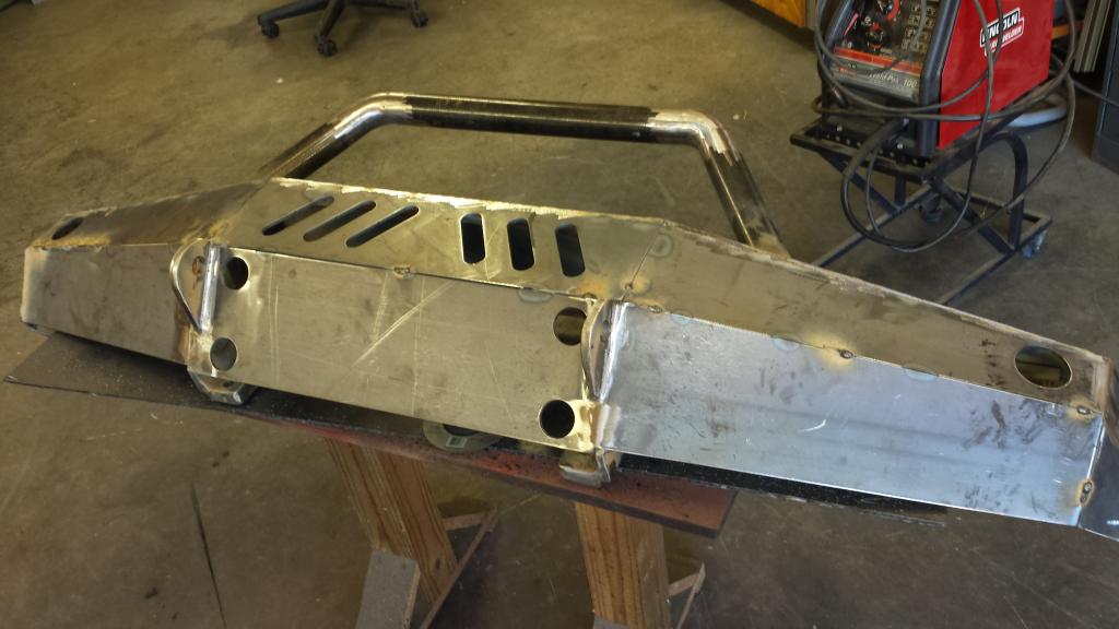

Old Oct 8, 2014 | 12:15 PM
highonpottery's Avatar
Joined: Aug 2007
Posts: 2,920
Likes: 19
From: Newcastle
sweet, looks great!
wood templates for steel, or keeping it wood?
I'd suggest getting a front crossmember weld-on brace/frame support, it'll really beef up the mounting with steel thicker than cardstock, lol. 4xInnovations carries some.
Old Oct 8, 2014 | 12:53 PM
rattlewagon's Avatar
Joined: Oct 2009
Posts: 4,832
Likes: 332
From: Northfield, Vermont
Originally Posted by highonpottery
sweet, looks great!
My thoughts exactly. The front of these frames are pretty thing. If you plan on winching, get the brace.
Cant wait to see it finished!
Old Oct 8, 2014 | 02:16 PM
Joined: Sep 2009
Posts: 96
Thanks guys for the suggestions not going with winch yet, I will beef up crossmember as ive seen in some other builds.
