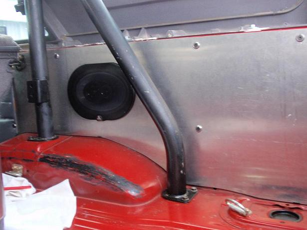

I used .080 because it is easier to work with, and holds its shape better. Any thinner and it really doesn't have that much rigidity. I was able to make all my cuts with a jig-saw with a 14 TPI blade. Any higher TPI and it gums up since the Aluminum is so soft.
For the rear corners where the OE curves, I left it flat and just butted it into the corner. You can see this in the 3rd picture of the original post.
As for rattling, I haven't had any. I put foam tape around the perimeter, then fastened it to the bed sides with sheet metal screws.
My original intent was to add additional storage, but then I realized how strong it was and decided to mount some speakers to it instead I will gain a bit, but not too much more over stock.

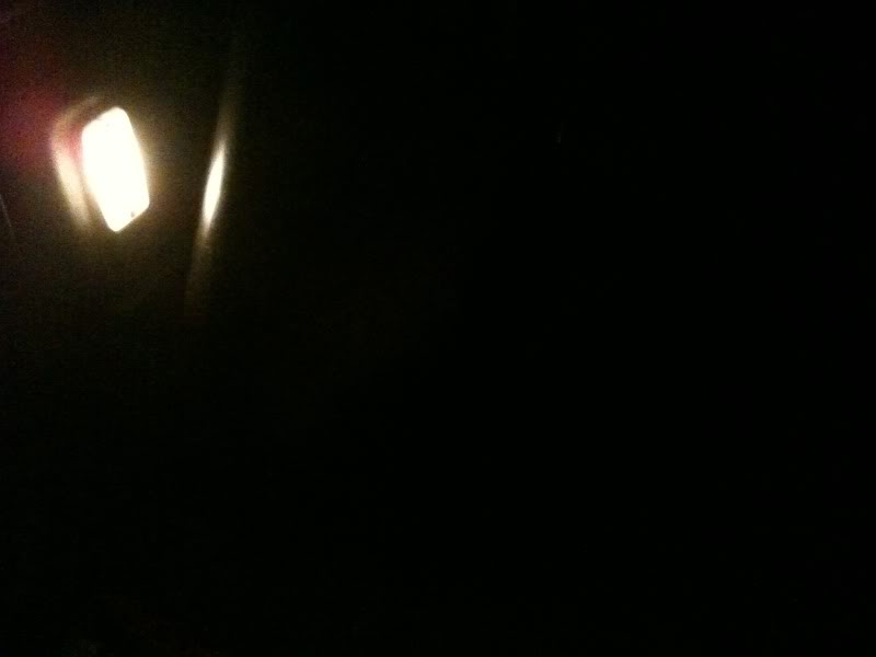

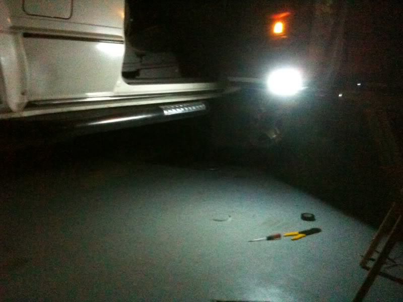

Bryan those panels look good. one thing that will help is adding to that little light back there. Inspired by 4 crawlers write up....http://www.4crawler.com/4x4/CheapTri...l#DeckLightMod
I found someone on CL selling waterproof flexible LED strips, bought a bunch for myself and the other locals here and went to town.
$15 bought a 3 meter strip that you could cut and solder new wires on to make multiple lights. I made 2- 9 LED strips for the doors and used the rest for the rollbar, running the wires down the rollbar and tacking into the stock light. pics... (all taken with 3GS- no flash on this crappy camera...)
stock light

roll bar......
from inside
and the courtesy lights, only come on when you open the door, light up the ground as well as the step in .
