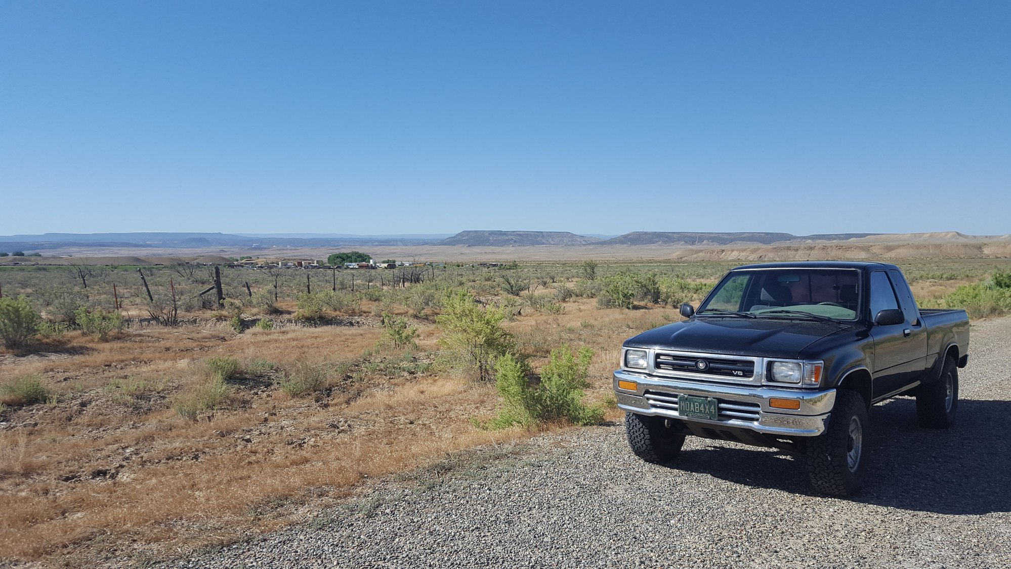

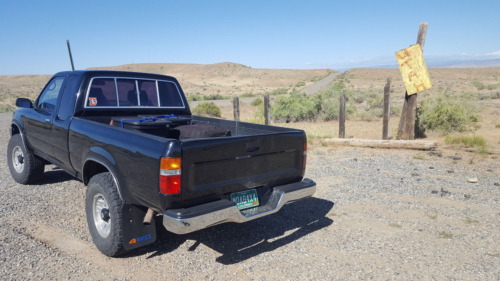

Glad you figured it out, I will remember that if I ever get a vibration similar.
430k Miles eh? Post some pics of the rig!

Nice looking truck!

Looks like youve been taking care of that truck!
