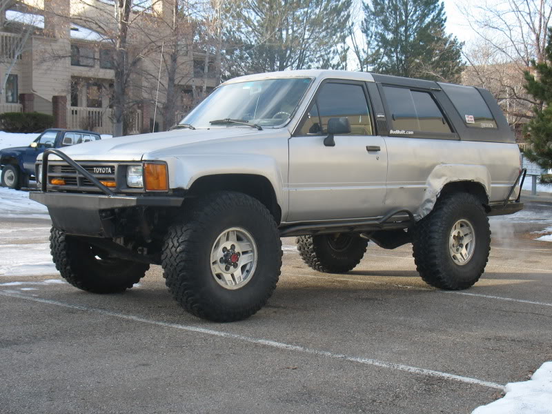

35x12.50's with zero lift in the front. I clearanced the fenders:
This suspension works a WHOLE lot better in its stock geometry. I've beat mine harder than all but a couple people on this site, and kept it together pretty well. I found it doesn't like being lifted much at all, especially the steering.
My suggestion would be to look into a 10.5 tire, rather than the 12. The 12's like to munch steering. I am rebuilding my entire steering system now with the exception of the steering box and pitman beause of this.
You can put on the spacers and reduce the lift by de cranking the torsions. Get smaller lift springs for the back. The 33x10.5s will fit great and perform quite well.
