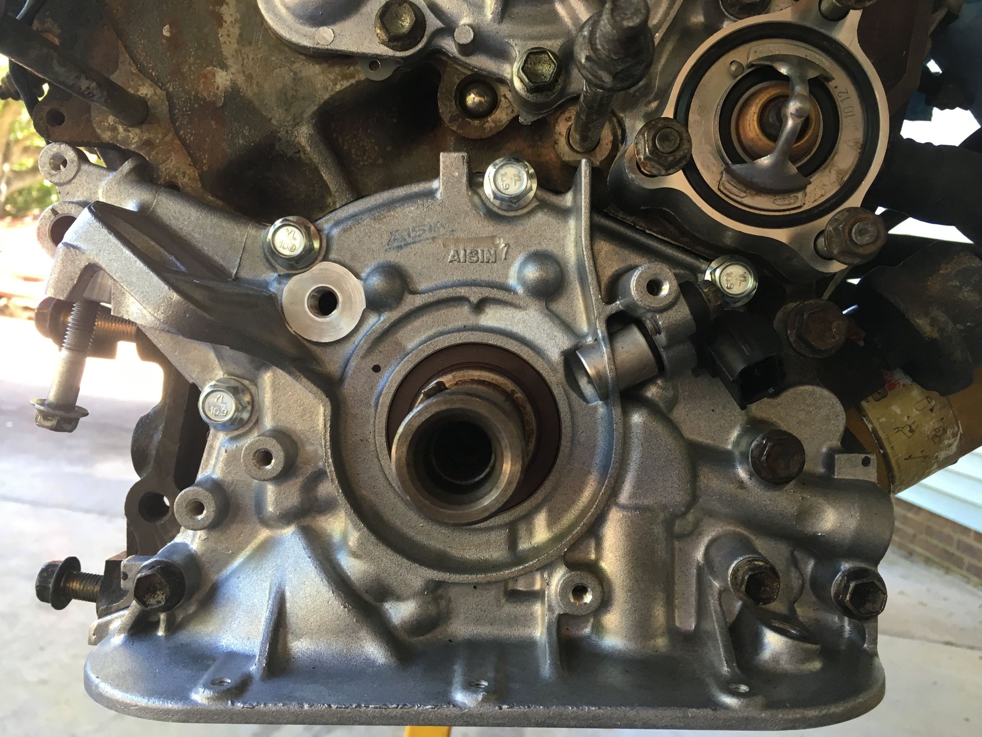

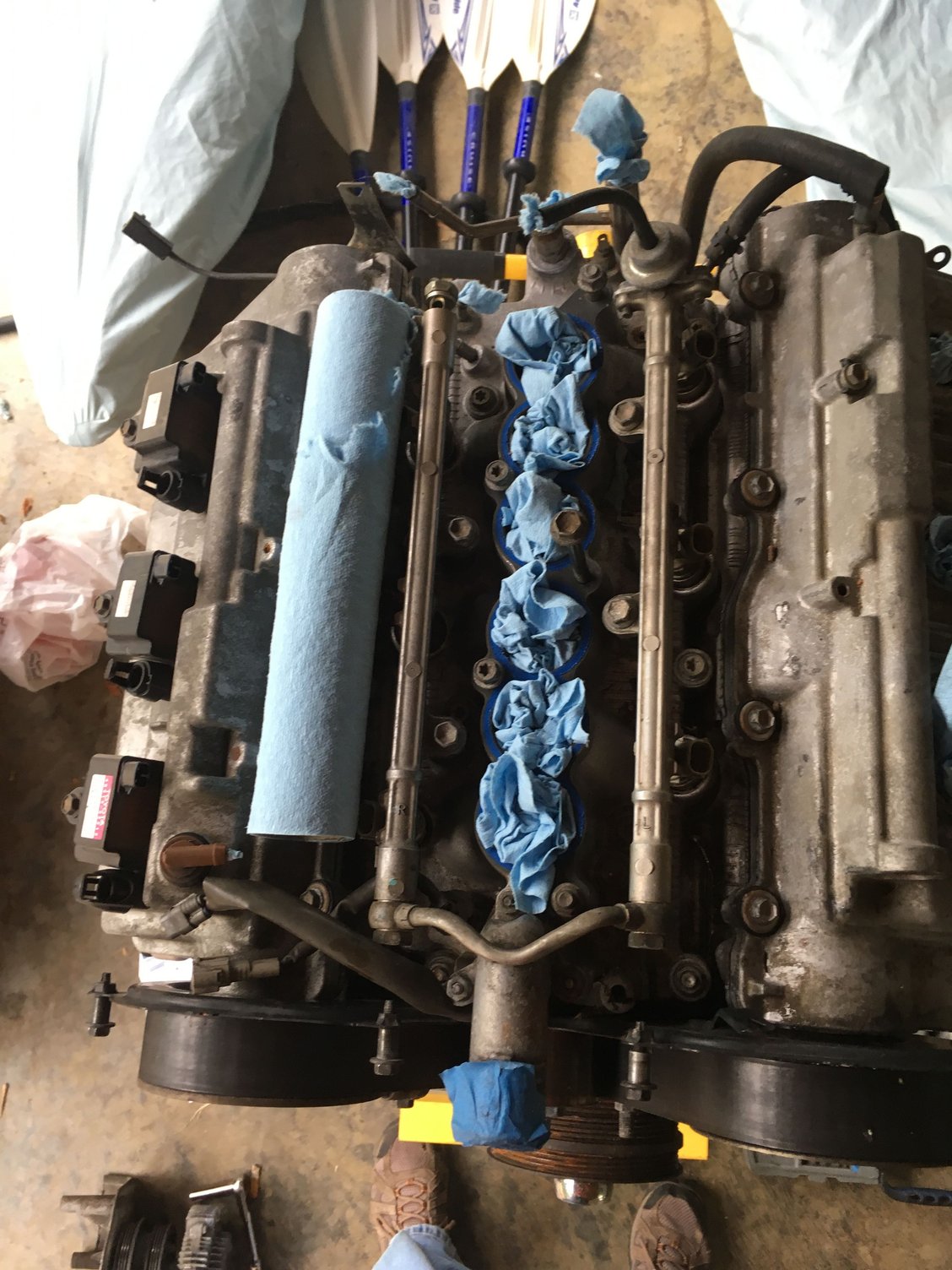

OK, so I had a bad root canal and blew my knee so I have not done much. But the engine is done, all new seals, cleaned, timing set, buttoned up. Below are a few pics of the mess. I'll probably wait until early October to pull the 3.0 as I need the truck for some home projects before summer ends.
anyway, enjoy some random pics of the process...
Sometimes yo just gotta leave the project and fish for Smallmouth
Timing belt coming off
Intake off

Oil pump and new front seal...
Rear Main, broke a bolt...yeah, you've done it too...sucks.
