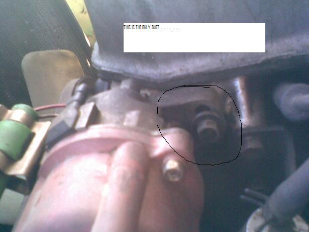

If you look straight at the distributor from the driver's side of the truck, I have removed a bolt (I believe it was a 14mm) from the right (towards the rear of the truck) and a small screw on the top of the distributor. I can not find any other bolts, but it is still attached as well as ever and will not budge.

This is the only bolt. try to wiggle it back and forth while pulling out.

So, I pried it off and kept going. Thanks for the help. Now, I am to the point of taking the head off. All of the head bolts came out easily except for one. I have taken it out far enough that there are no threads holding it in. The problem is that I can't get it out. I think that it is jammed or there is soot of some sort clogging it. I called my big 250lb wrestler of a neighbor and he couldn't get it out. Are there any suggestions?
