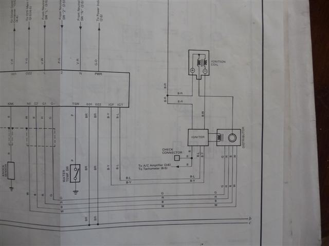

Trying to check to see what the wiring color code is, i.e., red to red, white to white. Can someone take a picture of their 89 3.0 distributor wiring for me and or possibly send me a link to an 89 fsm. thanks

Here is a picture of the '89 FSM wiring diagram for the 3.0 distributor. Looks like the wires maintain the same colors through the connector.
