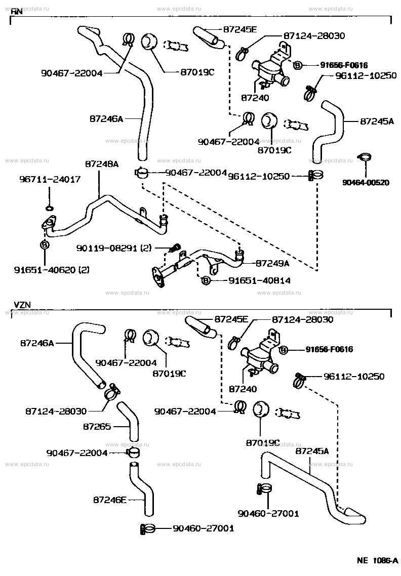

Does anyone know the number for the left heater hose outlet. Its a 1989 v6 2wd manual pickup
not been able to find the correct hose.
I got a dayco C86064 but the bend didnt seem right so I returned it. I need to replace it bc it was rubbing behind the upper intake manifold. Almost made a hole in it.

You should go to Toyota EPC and put in your vehicle data. Then you can pretty easily find the right hose for your application. You took a nice photo, but with more than one hose in the photo it's hard to know which one you need.
The good thing about someone going to Toyota EPC for the first time is they'll have to put in data to begin the search. Typically the first part of the model# . Helps people understand why simply saying "I have a v6 4x4 truck" isn't helpful, and especially regarding part numbers.

Still have not had lucky finding this hose. Its the heater core outlet that goes to the back of the motor. Connects to the sensor block on the back of the motor.

one of these?

I believe you are looking for PN: 44412-35090 (Hose, Return)
Here's a link to a place to buy it. The shipping cost can eat into the discount vs buying at a brick and mortar dealership, so it's best to get anything else you need too since they bundle shipping cost.
