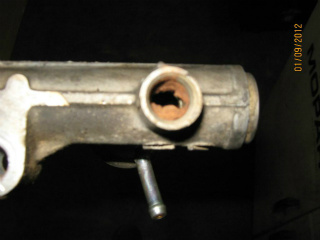

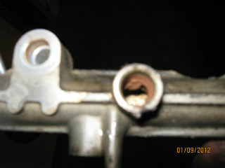

Old Jan 10, 2012 | 06:12 PM
  #33
mattsmopars's Avatar
Joined: Dec 2011
Posts: 17
Back to the original issue that i had. The plugged up fuel injectors and rail. Here are a few pictures showing what was inside the rail where the injectors go in. For everyone viewing pleasure.
Matt
