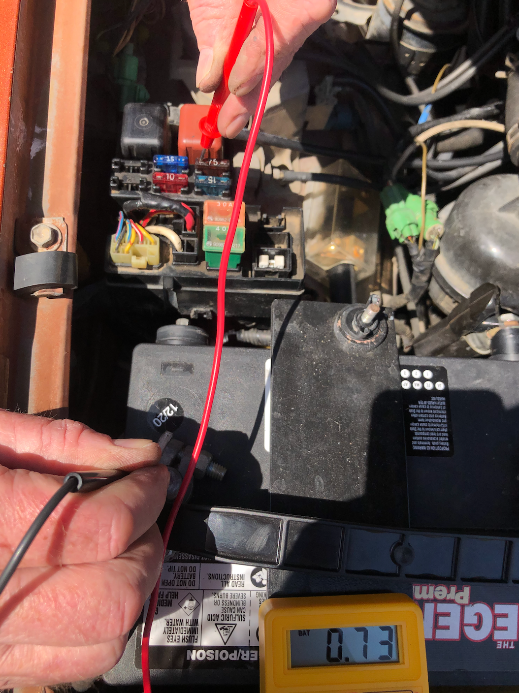

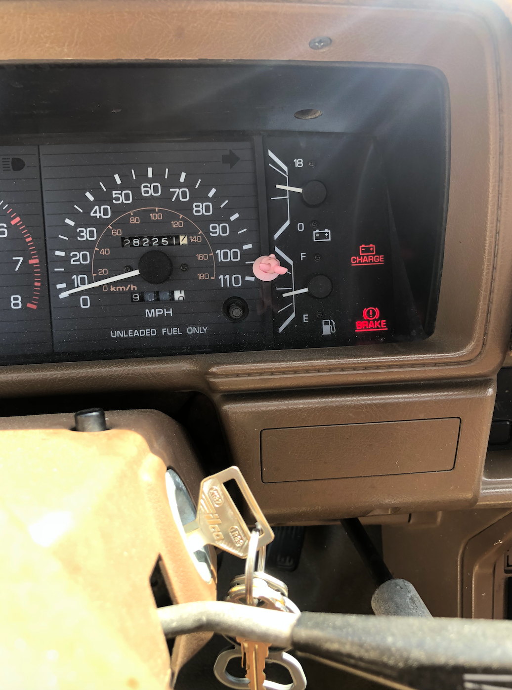

Details: The charge light and brake light are illuminated on my dash. At the G2 junction on the included (1988)wiring diagram, I get a reading of ~16v(new alternator). When I put the multimeter to the battery, I only get the voltage of the battery-no charging/alternator output voltage. At the entry point to the fuse block, I get the battery voltage reading. This problem began after washing my engine bay. I've included images of my findings.

Charge light and brake light on the dash
The (New) battery and its voltage with the car running
The voltage reading at the G2 connection. This is coming from the alternator
Reading at the charge fuse right side
Reading at the charge fuse left side
Charge fuse out - left side
Charge fuse out - right side

Readings at charge fuse are as expected. "L" (fault) signal from alternator is pulling it low to ground negative side of charge and brake fault bulbs
My educated guess is:
1) There is break in "B" wire between the "G2" and battery positive.
2) Thin wire "S" input into alternator taps off that segment of thick "B" wire.
3) Because "S" does not see that voltage, alt needs to bump up alt output, causing overcharging.
