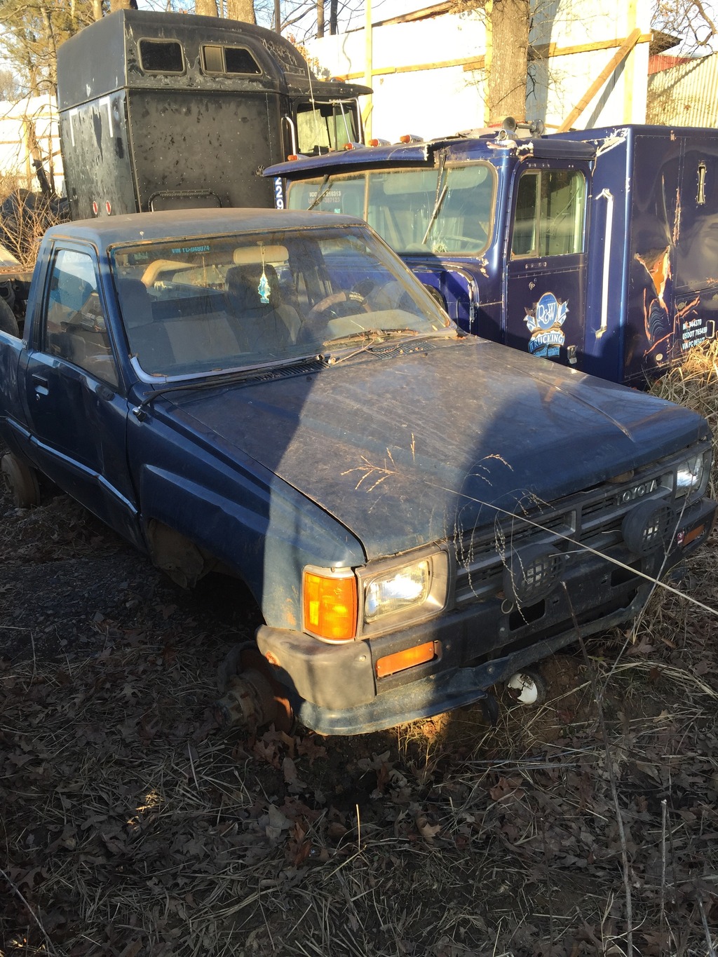

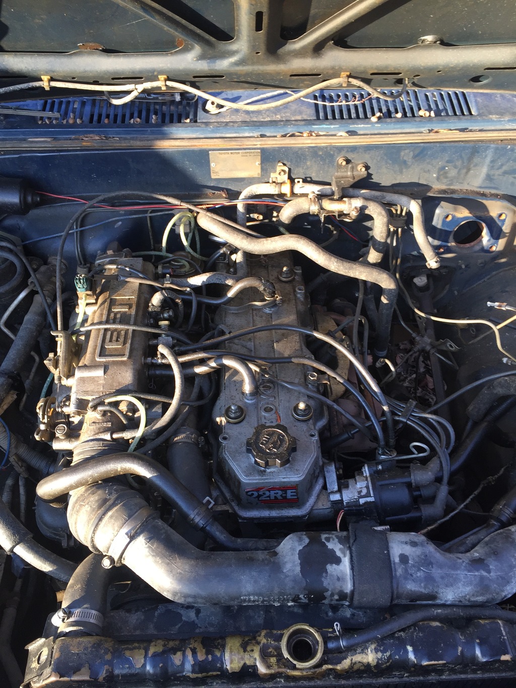

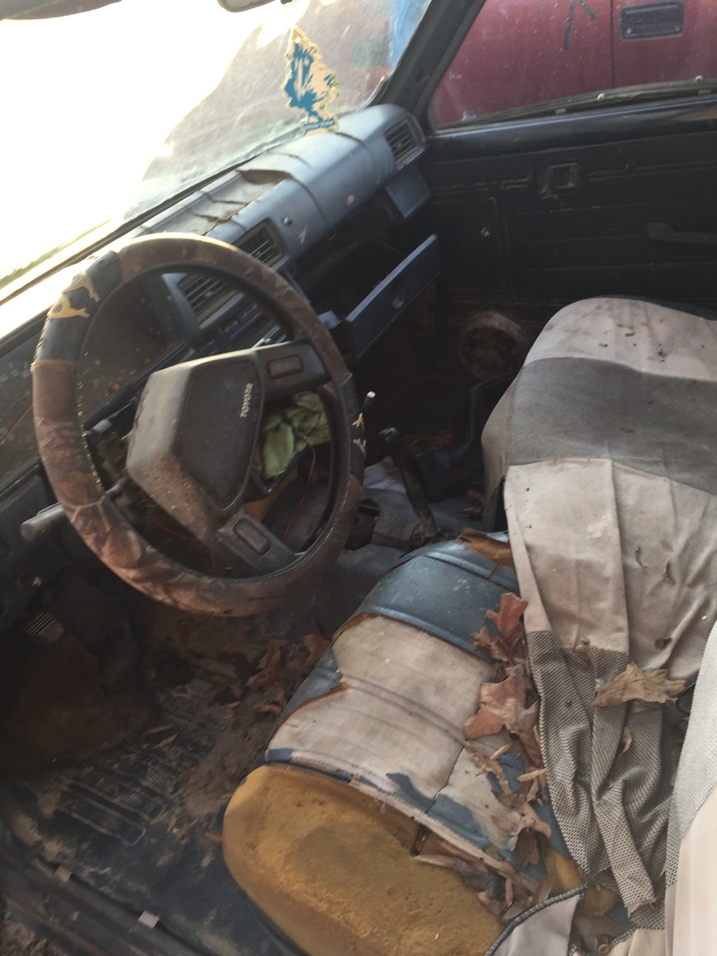

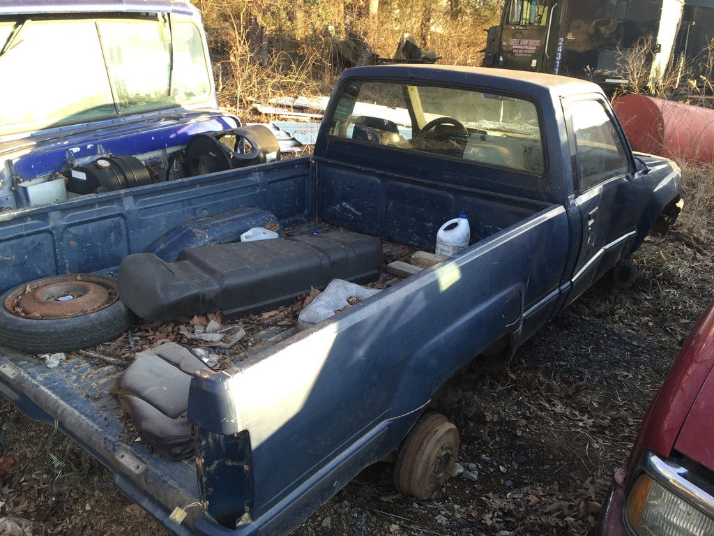

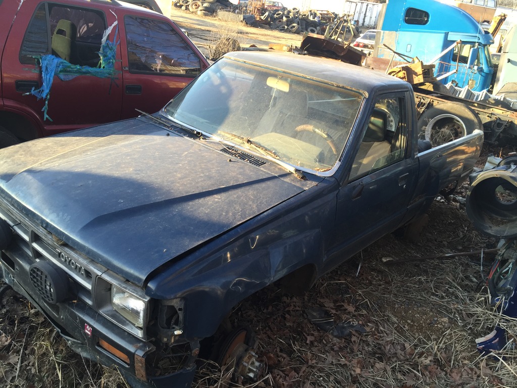

Ok so scored a 1987 single cab efi 4x4 truck missing only rims and tires for $400! Gonna load it up tomorrow. I wish I could just fix this one up and park the extended cab but it was at a scrap yard and I doubt I could get a title for it.....? Anyway I'm going to try and get pictures before the days out.

I did exactly what you did... I bought a junkyard 22re and converted it to carb to work in my 87.
The exhaust manifold from the re might have an o2 sensor hole in it... Best just to use the manifold from your 87.
Honestly, the easiest thing to do is to put both motors on stands, strip down the efi motor to the long block, and then xfer all the carbed stuff over.
Id heard that the two motors might have different cams, but then I read elsewhere that it was just a myth, so I left the '94 cam in the '94 motor.
Id highly suggest doing the timing chain guides on your efi motor before you put it all together.
I tossed all the efi stuff and harness into a tupperware tub, and sold it on craigslist for $100. In hindsight, I might have held on to it.
