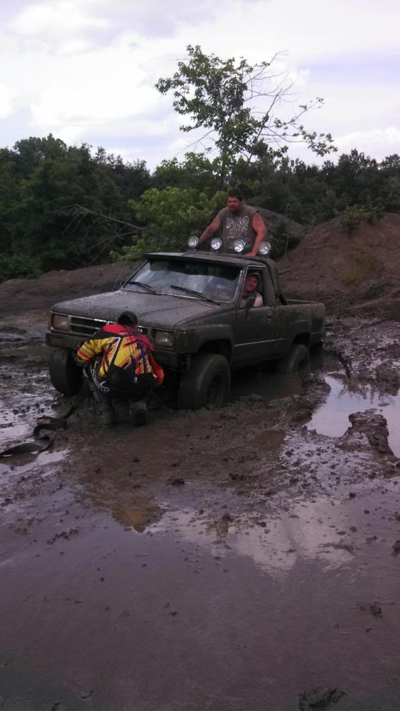

whelp tranny locked up and I blew the engine. but I did have fun this weekend.
