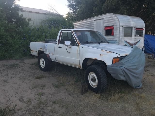

As suggested by a fellow Forum Member, I'm creating a new thread to share the restoration that I am doing to my 1986 Toyota Turbo Manual Transmission Standard Cab.
I live in South Florida but am from Northern California. I picked up last week a pretty rough 1986 Yota Pickup from a guy who got it from a tow yard. The engine is in pieces and it has rust, but I pulled the trigger on it as I am looking for a looooong term project.
The seller claimed not to know much about the trick but I did some digging and found out who the previous owner was to find out what the heck happened to the truck. Turns out the previous owner is a woman who loved the truck but who's son blew up the engine by driving it without oil. I got some other interesting information about the truck and she asked my to share pictures of the restoration.
I just had the truck dropped off at Yota 1 in Riverbank California where I hope to get the engine built and put back in the truck so I can get it running. After that, I'll have it shipped to me where I plan on cleaning up the frame, get body work, work on the interior, etc. I have worked on other older cars like a 1971 C10 and 1967 Mustang but nothing this extensive. I'll take my time and do as much as possible myself.
Interested in getting any tips on how to manage the restoration as I am just starting. Below are some pics.
