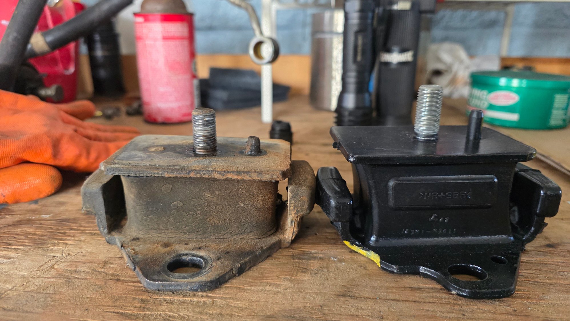

Is this normal wear or is the new one too tall?

i wouldn't expect that the old one would be compressed that much from wear?? if anything the rubber would be broken off of the metal, i'd try getting the correct height.

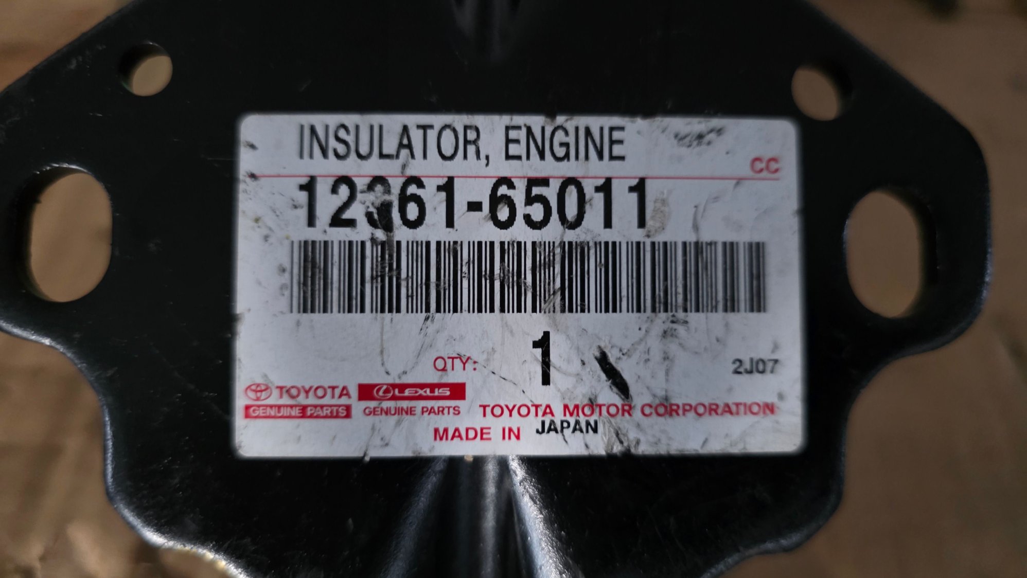

looks like it's not for a 22re? bizarre wording for that part number Does NOT fit 2WD/RWD 22R & 22RE https://www.yotashop.com/motor-mount...t-12361-65011/
this looks shorter, but why offset? says that it fits: https://www.yotashop.com/toyota-4run...5-12301-35141/
Hi,
Yes the wording is odd. I actually thought that they posted 2wd/rwd because most people don't realize rwd mean 4x2
Problem is these are the right part # so its really hard to find the corrct one..haha.
it list rte 4runner that only come 4x4 that was pretty much what i was going off of.
I cant find much info which brought me to the conclusion they will fit.... humm...I hope.
