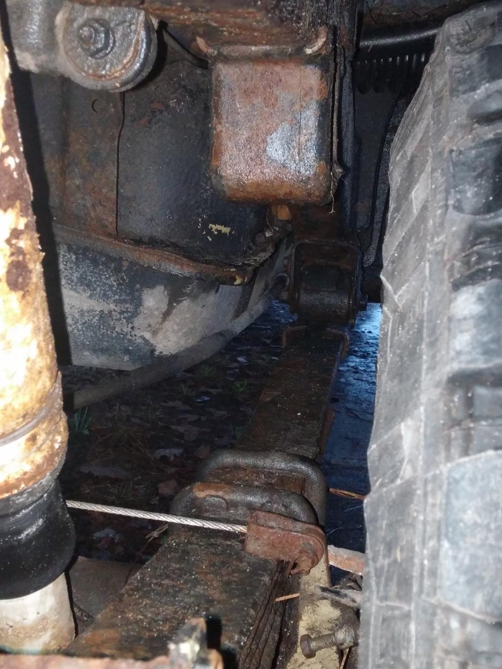

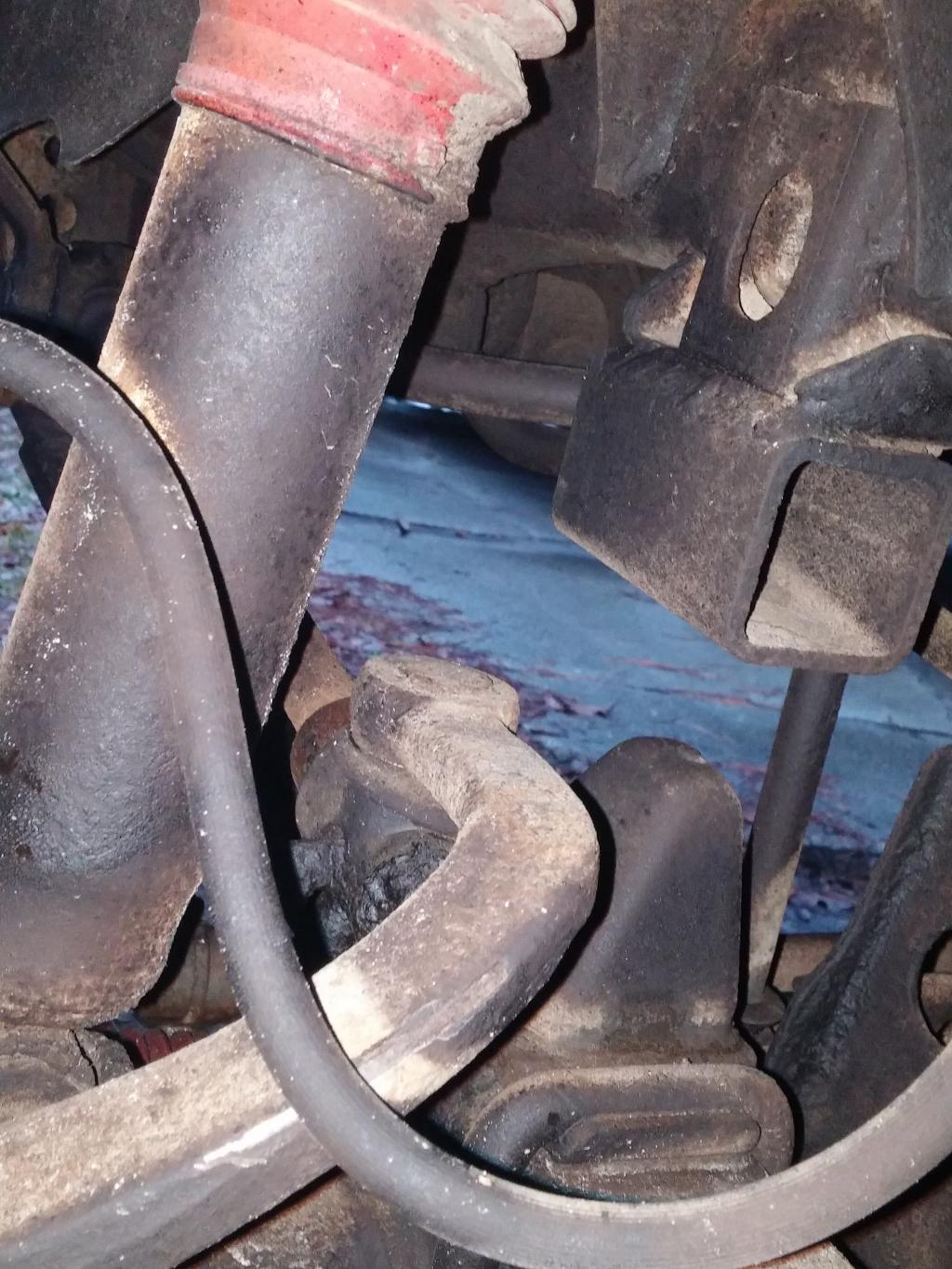

The front of my truck is getting lowers than it used to be, I hit the bump stops when I hit a major pot hole now. I was looking at the zux mod to help with the rear which is also sagging due to the heavy flatbed. Here's the picture of the front. Name:  20141229_163257_zpsbpw0lnlj.jpg

I'm currently researching how to zuk the rear.

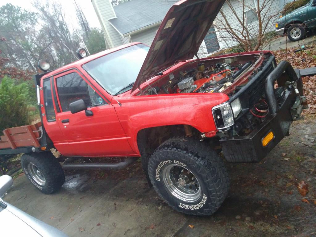

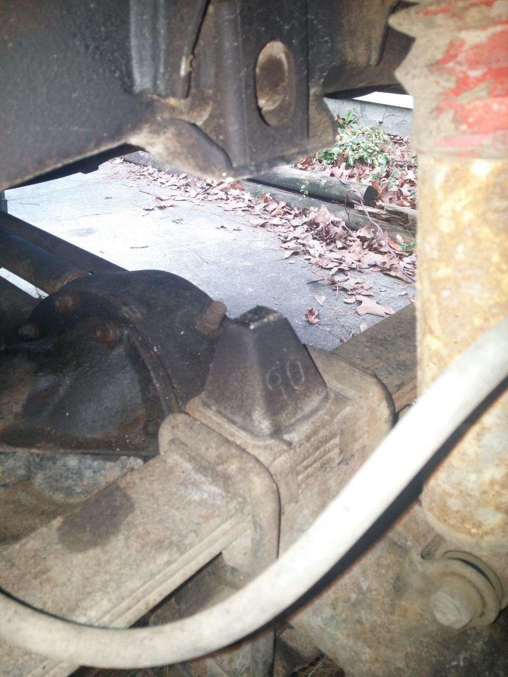

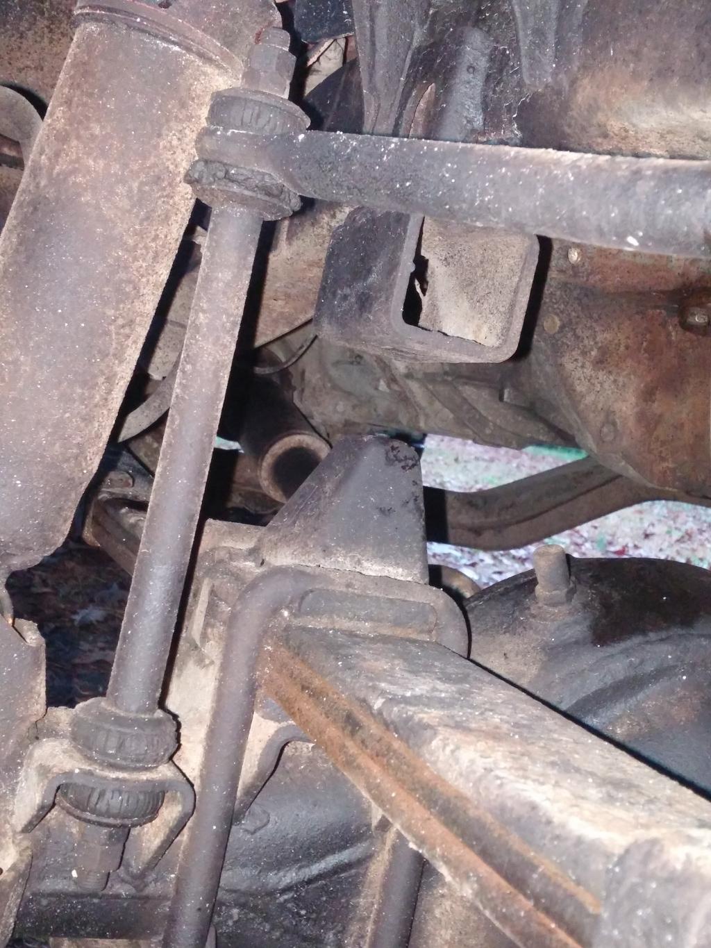

I've also been really getting into trail riding and light rocks. I don't want to build a rock crawler but a little more flex would be nice! How do I get that!! Here's a pic of the rear and of the beast
Just recently got the truck to where I live. It had been sitting back home for 2 years. Now that I have 2 other DDs I have more room to build it up. I'm currently collecting parts to convert an a/c compressor to an oba system.
Please give me any tips or criticism you have!

The 2" box tubing welded to the bottom of the bump stop landing pad doesn't help.....you're losing 2" of up travel right there!

Oatmeal had a good point on the 2" square tubing, removing that will gain you some articulation. I noticed you still have the front sway bar, you'll gain some flex by removing it. I ran the Zuk mod on the back of my 4runner for a couple years using jeep TJ coils until I could afford a new lift. It helped a lot with body roll and payload, and flexed ok.

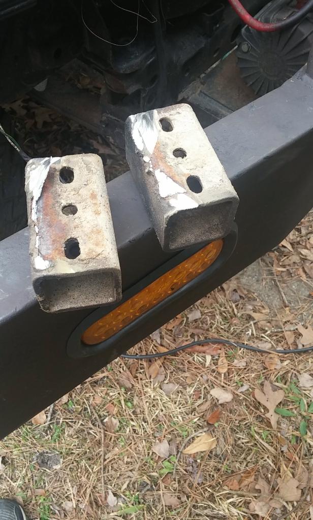

I got those pieces of square tube out today. Should be a lot less bangs when I hit a pot hole now!
Now I just need new springs all the way around.
