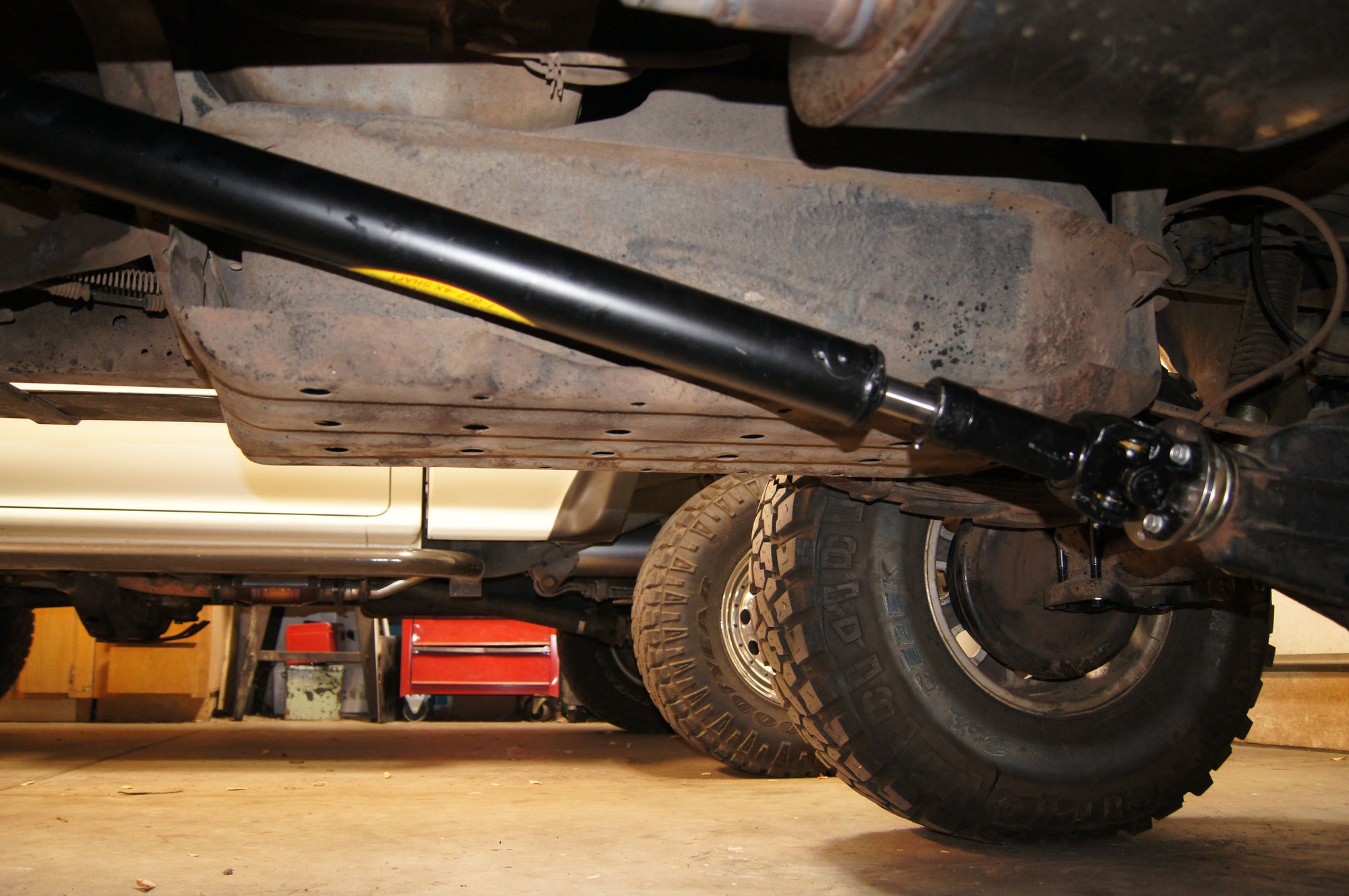

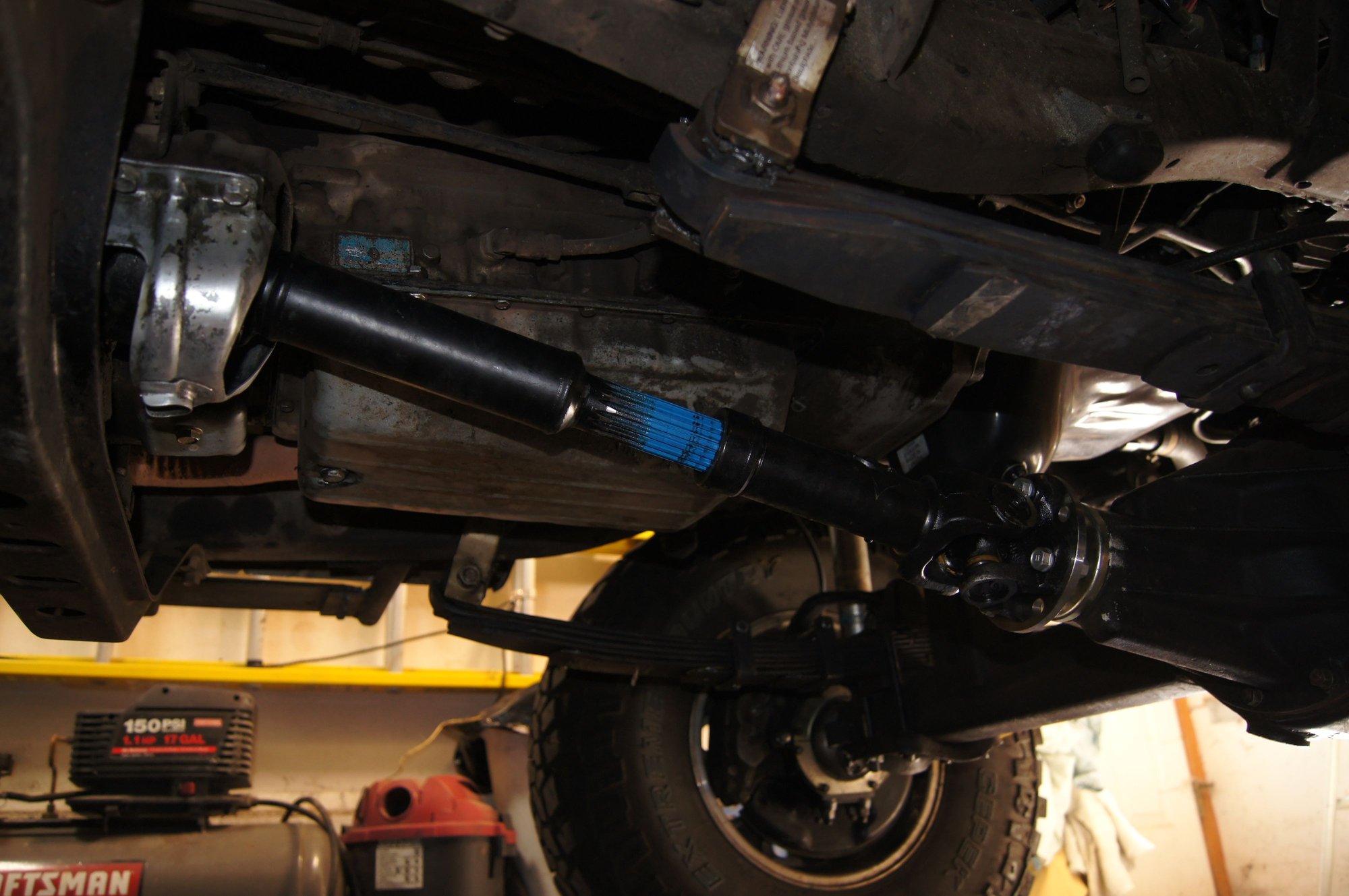

Can you post up a picture of the complete rear shaft installed from a couple of different angles

I finally got around to fixing this and am reporting back. I went with Tom Woods double cardan driveshafts both front and rear and the grinding sound at 65+ mph is gone. I also went with rear axle shims (1/4 inch) and opted to replace my ubolts. With the added shim pack, I had to extend the ebrake shoe height and went with 4Crawler's product. After a little bit of modification, they turned out pretty good. So, thanks everyone for your help. It was nice driving into town today and not hearing that dreadful sound.
