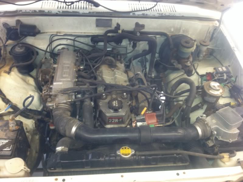

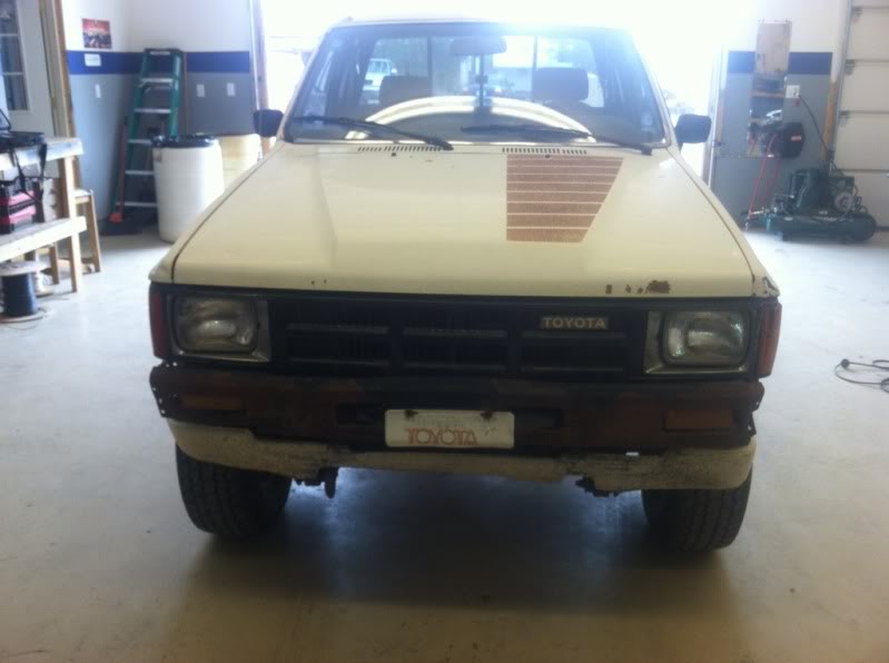

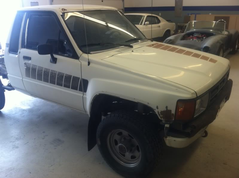

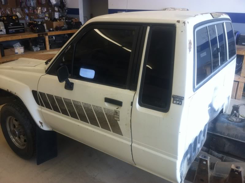

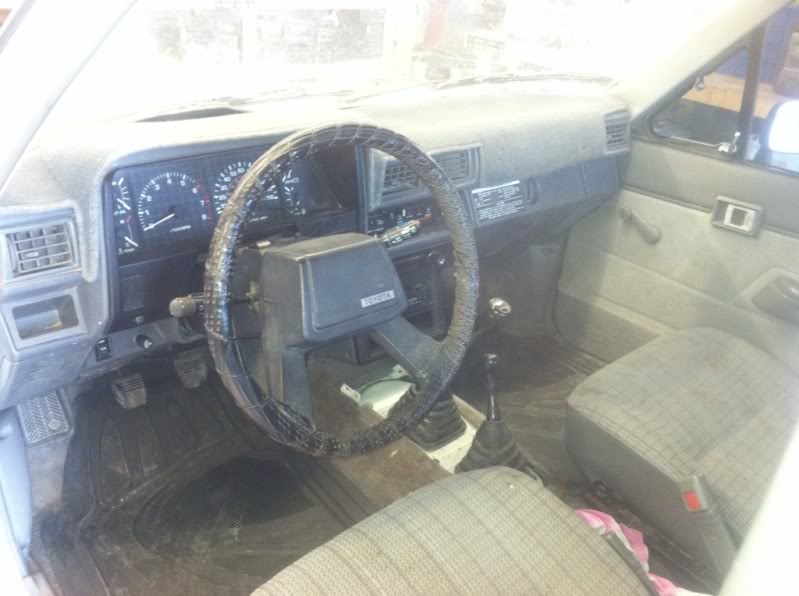

Bringing this back from the dead I ended up picking up the extended cab and have done some work to get it running, dump and clean the fuel tank and lines , new fuel pump, oil change plugs & wires, coolant flush and a new exhaust. And a new clutch tranny and tranfer case. Seems to run great and smooth but I'm not sure if I have the time or wanna invest more into it. Anyhow here are some pics let me know what you guys think also if I was to continue with a buildup what would you guys do!? Thanks!!

hopefully you got 50% of your money on the deal since you had to put money into this rig. after the work done, i'd say the rig is in good enough of a state to drive around regularly. i would probably just do some simple things like service the axle fluids, repack wheel bearings and flush out the brakes of all the old fluid -- basically everything that gets "old" when the rig sits for so long. other than that, looks like all you need is a bed/flatbed.
building the rig up will cost you a lot more $ - probably more than you want to spend after having just sank so much into it. next step would be to get enough lift under the rig to increase tire size (or cut metal to make them fit)....but IIRC a pre-IFS rig takes just as much work to upgrade to hi-steer as it would to do an outright SAS on IFS rig. to accompany the tires would be gears and lockers. then might be dual t-cases if planning to crawl. the rest is basically armor like f/r bumpers, rock sliders, flatbed, etc etc. I think you really need to decide what your plans are for this rig first now that it's back to driveable condition.
good luck!

Thanks for the input, ya I didnt trade on the labor I did the work got paid cash then a couple months later he called me and asked if I was still interested and went to pick it up for a killer deal:-)
Good idea I was planning on all the fluids and grease shafts/ bearings next, maybe the brakes too. I was very surprised that this thing doest leak a drop of anything!
I also have the bed I just removed it to do the fuel pump. Do these all run so stiff?
