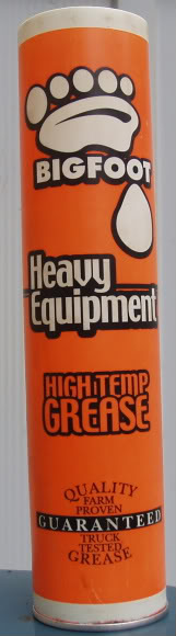

I've been using strictly BIGFOOT EXTREME PRESSURE GREASE(a.k.a. Bigfoot EP 2 grease)for everything on my rig for the last 3 years. It's worked great for wheel bearings and everything else. I love it! Super heavy-duty stuff. Exceeds 75 lbs. in the Timken OK load test(which is all that matters to me when I look at a grease's properties). You're not going to find too many greases on the market that can rival that. I've only found two, Lucas Oil Marine Grease@80 lbs. Timken OK load and Red-i Water Sport Marine Utility Grease@85+ lbs. Timken OK load(Red-i is made by the same people that make BIGFOOT). They sell BIGFOOT at my local NAPA. If they're out of it my second choice would be Lucas Oil X-TRA Heavy-Duty Grease. I've used it before, it's not bad. It's virtually waterproof and tests out@60 lbs. Timken OK load and they've got it there too. I've heard and read lots of good testimonials for it from other off-roaders too. They also sell Lucas Oil Red 'N' Tacky #2, but BIGFOOT is a better "tacky" type grease for my money. BIGFOOT outperforms it in all respects, and it would never do as a substitute for it in my book(Red 'N' Tacky #2 only tests out@60 lbs. Timken OK load).
CATEGORICALLY THE BEST HIGH TEMPERATURE /MULTI-PURPOSE/ TACKY-ADHESIVE EP GREASE FOR HEAVY DUTY, SEVERE SERVICE APPLICATIONS.
Product Description:
BIGFOOT GREASE is a superior Lithium Complex Grease to provide excellent lubricating qualities over a wide range of temperatures. Designed for work under the toughest conditions in operating temperatures from -40°F to +450°F (-40°C to +200°C ), with excellent mechanical and chemical stability. BIGFOOT is the grease designed to always ''stay in place'' under the worst operating conditions of water-dirt-mud, providing maximum protection.
Typical Uses:
Recommended for wheel bearing, including disc brake applications, fifth wheels, U-joints, steering linkage, and chassis lubricant.
The adhesive and water resistance qualities of this grease make it an ideal chassis lubricant for “off - road” trucks, construction equipment, agricultural equipment, logging equipment and mining equipment.
Also recommended for rock crushers, oil field equipment, off shore drilling equipment and marine deck equipment.
Recommended for all types of bearings including plain bearings, heavily loaded journal bearings, ball and roller bearings, needle bearings and couplings.
Features:
Outstanding wide temperature range grease.
Unequalled water washout resistance.
Excellent shock load-carrying ability.
Rust and corrosion inhibited to protect metal surfaces.
Adhesive-tacky grease that “stays in place”.
Extreme pressure protection - 75+ Lb. Timken OK Load Test.
Dyed Fire Orange to better detect defective bearing seals.
Oxidation inhibitors permit high temperature operations.
Less down time on your equipment.
Melting point well above 500°F.
Excellent grease for most sealed-for-life bearings.
NLGI Certified GC-LB in wheel bearing and chassis
applications.
http://www.lsc-online.com/products.php?c=12

BIGFOOT is $3.99 a tube and can't be beat. So why buy anything that won't perform as well? If cost isn't a factor.
Good grease = Cheap insurance!
