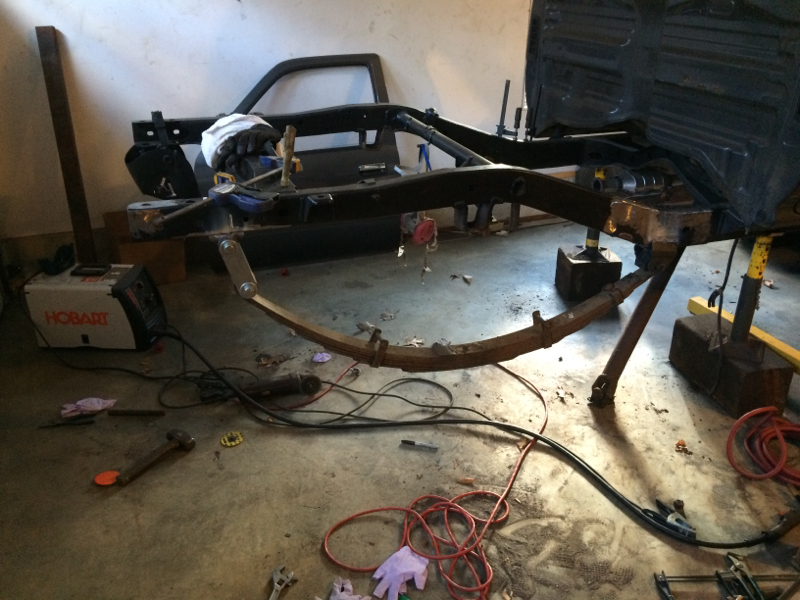

Just put some 5"trail gear springs on my 1984 frame, I want to see the the proper angle for the shackle to be at on the rear springs. I moved the front hanger 6" forward and the shackle hanger 2"to the rear.

I would wait to fully weld that rear shackle mount until you have the full weight of the bed, tank etc sitting on the springs.
Just tack for now, adjust later.

Yeah everything is just tacked up right now, just want to know if the shackles are at the right angle right now as they sit with no wait on them
