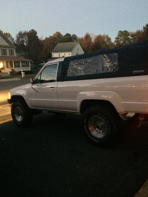

31's were one of the first things I put on my '89. You won't discern any difference in power and the turn radius is fine. If you were to move up another inch, to 32's, you might have some rubbing but at that size most people are able to hammer the fender a little. IMO 31's are a no brainer. There are more tire choices among AT and MT rated tires than the size you now have. My '89 has Firestone Destination because they were cheap. They look good IMO but they don't have a warranty. I have Cooper Destination AT's on my 2000 4Runner and they are supposed to last 50,000 miles. I'll probably stay with Coopers in the future and they're made in the USA. Here's a not so great pic of the '89. My photobucket is disorganized. I forgot to tell the dealer to turn the white letters in and I'm too cheap to remount them. My son likes the white letters anyway.
