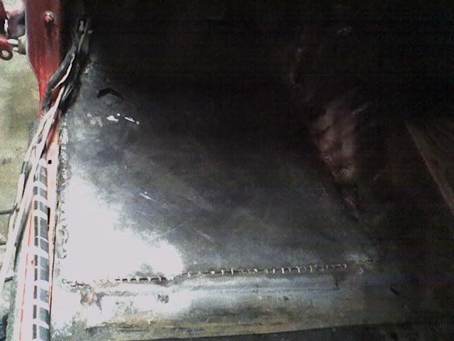

I used 16ga sheet metal to construct a new rocker channel (I forgot to get a pic of this) and rewelded the body mount back onto the channel. After this a new floor pan was cut and bent up to fit in the flintstone-sized gap and it was welded in place with spot welds along the edge.

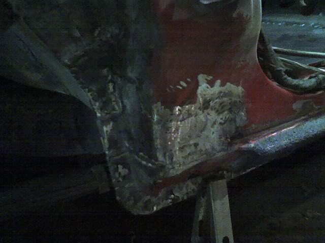

I also had to reconstruct some of the corner of the body using 22ga metal.

Tomorrow I will reinspect everything and if it looks good seal the seams with silicone and coat everything with herculiner for durability.
