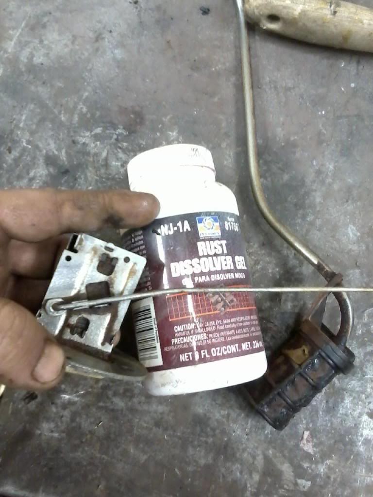

Hey guys, thanks for the replies. I ended up being the filter in the tank along with the metal pickup lines being clogged up. The tank didnt have rust but alot of black sediment and slime all over it. I cleaned the entire fuel system, tank and lines and now it runs great. Still having issues getting it to pass smog but now that it actually runs, I can get a tech to diagnose the smog issue.
