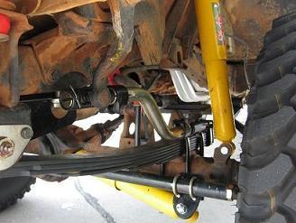

Originally Posted by Wardamneagle
I also had to install a Pro-comp drop draglink. My stock draglink hit the front U-bolt even though I had installed the special OME flattened U-bolts. OME said that shouldn't happen, but it did. I think Randy had the same problem. My torque rod fit fine.
Can you take a picture of your setup I would like to see your drag link.
This is the only photo that I have. Hope it helps. I would take more but I'm in England and the 4Runner is in Alabama. Hope the weather is better in Alabama at the moment!
