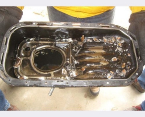

Today ifound golden metal flakes and pieces in my oil pan. she still starts good and runs hard, but I have noticed a lack of horse power and gas mileage lately. What do you think? Thanks everyone!

did you pull the oil pan or did the flakes come out with the oil at oil change time?
pictures?
and are we talking FLAKES, or DUST?
flakes tell me bearings, and thats no bueno. but without seeing pictures, i couldnt tell you for sure. any weird noises?

I pulled the oil pan to replace the gasket and i noticed flakes. Gold/ court colored. Also got in it a bit last week and noticed she hung up a bit at like 3 grand then ran fine. I do have a picture but i can't figure out how to upload it from a phone!

Well slo6i hit the nail on the head. did it look like these pictures below?

You guys hit it on the head....bearings

If it were me, rather than just buying a new motor, I would tear it down and check the extent of damage. It sounds like, based on your description, that there wasn't any weird noises so you may have just spun a bearing and can get by with a new bearing set, and regrinding the crank.
You'll have to tear it down and get everything measured to see what's out of tolerance and where to go from there.
