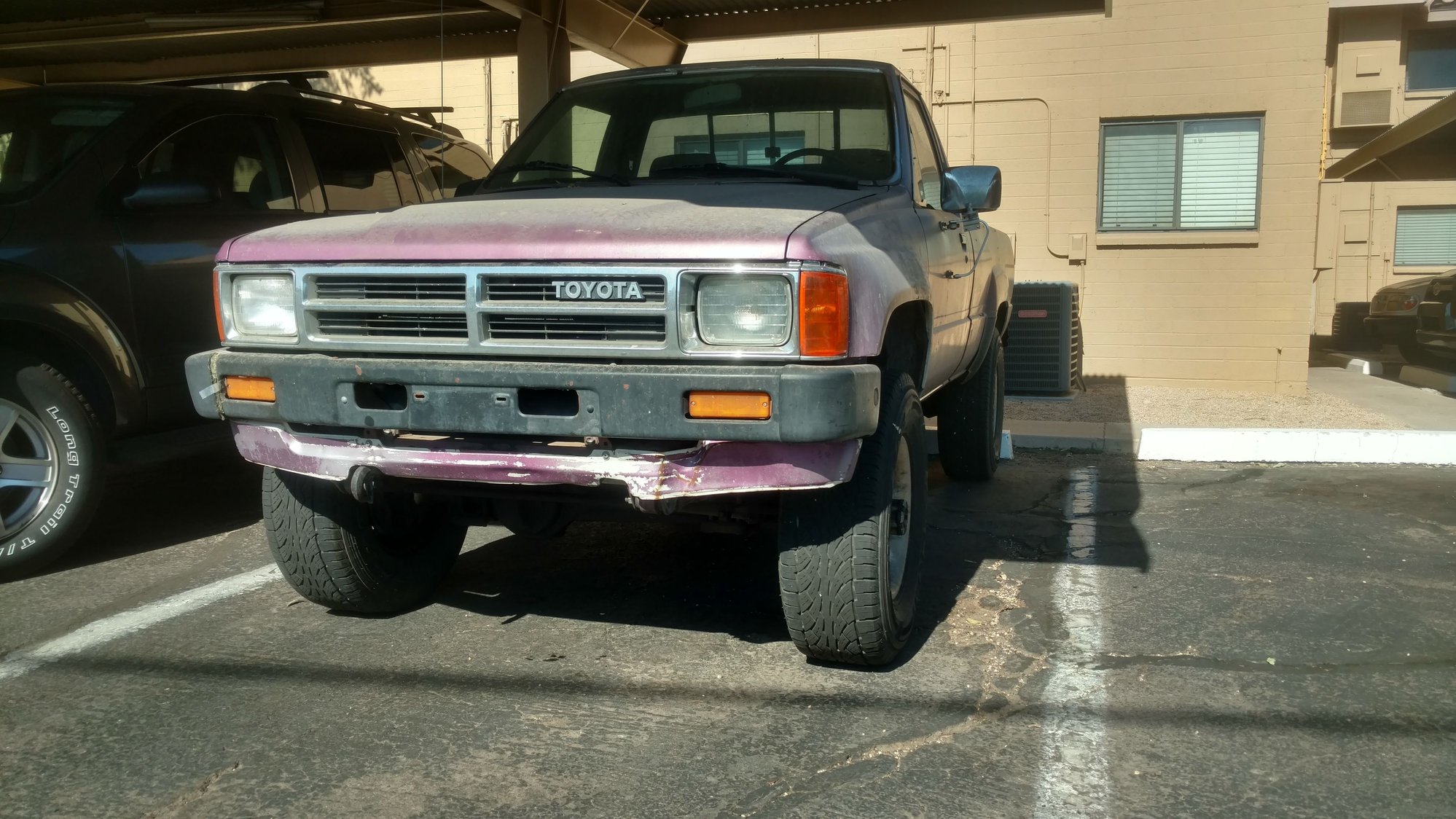

Picked up this gem for $800 today
85 4x4, 5spd, carbureted, std cab, longbox, runs.
Planning to run 39's with the parts to do so properly (to which I am not afraid to cut and clearance any obstructions, such as firewall or anything else), and keep it as low as mechanically possible. Objective is to use it for a verticle mineshaft spelunking mule. Reliability being priority with capability a close second. I will do my best to keep updates on my unusual build, but have patience, as I work out of town a lot and will work on this in sparatic bursts at random times.

Donno why you'd want such grossly oversized tires to make that truck desert/mountain capable.
I think you're shooting yourself in the foot.
With moderate driving skills, armor, and lockers, anybody could take such a truck as yours and go anywhere, or more, places on 31-33 inch tires than you will be able to go with 39s'.
Looks like a very nice truck for the small money.

Donno why you'd want such grossly oversized tires to make that truck desert/mountain capable. I think you're shooting yourself in the foot. With moderate driving skills, armor, and lockers, anybody could take such a truck as yours and go anywhere, or more, places on 31-33 inch tires than you will be able to go with 39s'. Looks like a very nice truck for the small money.
I agree, very nice truck for the money. Again I agree, no need for the extreme tires. Save the money and get some lockers. 33s locked and a little lift will make that thing into a tank.

Nice score!! Any rust?
SFA trucks don't need the lift of a SAS truck to run large tires; as long as you don't mind trimming.
I say this is 'Merica build your truck your way and I'll build mine my way.

Nobodys telling him how to build his truck, I only suggested that if capability and reliability are main concerns, as the OP said that they were, the giant tires might get in the way of achieving those goals.
Those bloat wheels are more for show, than for go in the real world. Desert trails are often narrow, more so now that side by side quads are changing the old tracks into ever more narrow ones.
Tall tires good, wide tires....not so much..

My 85 is locked with 5" lift springs and 33s she goes pretty much anywhere I aim her.
I wish I could find another 85 for the cheap money you spent on that small cab rig you just got, I have ideas.

Gentlemen, I appreciate your input and concerns. The reason I'm aiming for large tires is simply for ground clearance under my axles and a little bit of wow factor (I can't lie, I love that look).
Since we will be going out vast distances from where the usual crowds go I want less of a chance bending a driveshaft, punching a diff, or flat getting hooked to a sharp rock. Most of where we will be going is Johnson Valley, Lucerne Valley, Death Valley, Arizona and Nevada wastelands. ALOT of rocks in all of those places. Trail width is not so much of an issue as I don't mind parking and hiking a bit. Not to mention, around here I can get race take-off tires at good prices. Running large tires on Yota axles will be manageable since I stay light on the throttle in challenging situations.
As a few of you have mentioned already, "to each his own". If I find my idea's to be counterproductive to my needs in the dirt I'll gladly open the "I told you so" envelope for you all.
Idea's and comments, whether good or bad, are always welcome. I know that you guys sure come up with some very compelling logic and I'm always listening.

Thank you. There is some bubbling rust under that horrifying salmon something paint, but strangely enough, it's on all the body parts I'll be tossing out. Fiberglass fenders, bedsides, hood, and some tube doors will clear it all up.
The frame is rust free with the exception of the rear from about the axle on back. Nothing a day with the wire brush and WD-40 won't fix.
