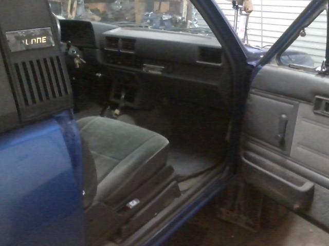

toyotafiberglass.com sells some and is a member on here. For most other pieces you are going to have to find them from the bone yard or. For plastic and vinyl you can use interior paint on them. I have used interior paint on several trucks and when done right, they look knew and last great.
You can get new carpet kits. The dash pad is the hard part to find, but they now have an over lay that goes over the dash and from what I have seen it looks great as well. I have yet to try it. I think the vendor is on here as well. Carid I think it is that sells them. Other then the seats which any upholstry shop can take care of for you, it is really easy to get a great looking interior.
Cleaning and prepping it the key to getting great results. Stacey David used it on Ted Nugents Bronco. The only issue I really have is where the Threshold gets stepped on from my kids getting in the truck. A rock or something stuck in their shoe will scratch thru. Below is a from my builds to give you an idea of how it can turn out. It actually looks better in person. One is 4 years old and the other is 3 years old and I have not redone any of the work to them since I finished it. I used blue, gray, brown interior pieces to complete my trucks.
Here is some pics from today. Still have not gotten the seats done.
Threshold I am talking about.

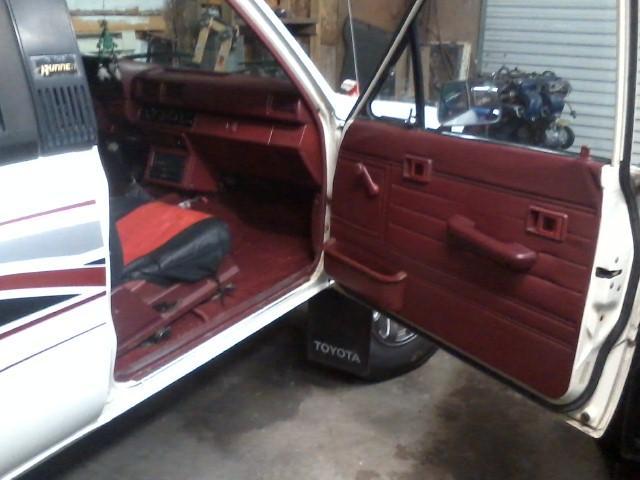

Here is my 86 runner. If you are having it mixed get three or four cans at the same time. If you can buy an off the shelf brand that is easier to go with.
