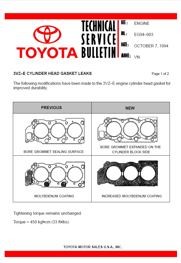

I want to know if there is any identifying mark or change in the gasket which I could use to determine if the gasket I am going to pull is the very first original one or a replacement. As a Mercedes Mechanic, I have pulled heads with hundreds of thousands of miles and for the most part all the numbers and manufacturing logos are readily visible since the gasket was sandwiched tightly between the surfaces.
Originally Posted by big1000
This is a good question I want to know as well
If you were to show me the head gaskets that are on the engine now, I could easily tell you if they were the original head gaskets installed on the engine or not. With a high degree of certainty.
Because....
There was an OEM head gasket design change that occured shortly after the vehicle was made(in 92). And a 92 with 90k miles would most likely have been a prime candidate for the V06 head gasket recall campaign which began in October of 94. Therefore, IF the dealer's story holds true, it would most likely have head gaskets of the newer design being installed during said recall(at some point after 10-7-94). If not, it would still have the older design head gaskets that were installed at the factory. Unless, it was serviced(w/ new head gaskets of the old design) at some point before the recall(before 10-7-94). Which I would consider to be very highly unlikely(since I don't believe in the 3VZ-E head gasket issue being anywhere near as common as most folks insist it is, and it wouldn't surprise me IN THE LEAST if yours went 289,000 miles on the original old design head gaskets installed at the factory in 92).
