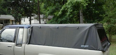

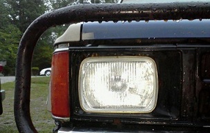

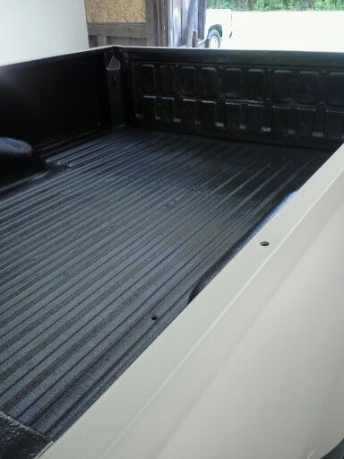

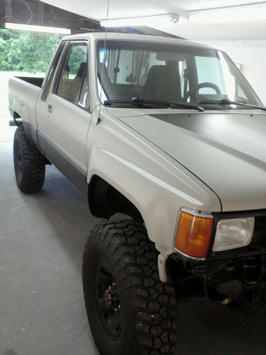

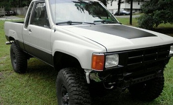

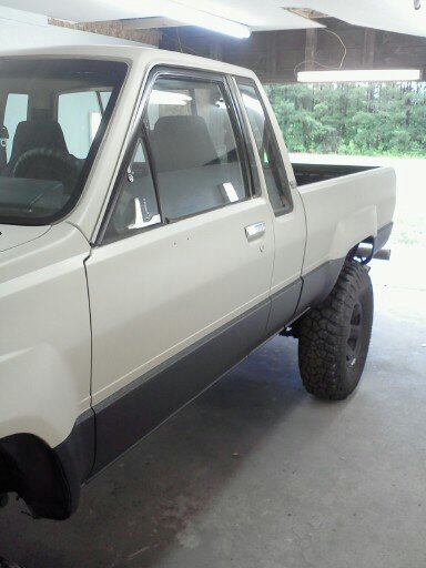

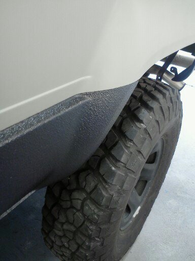

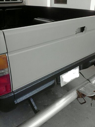

Here a few pics for the haters..... The ones with the Softopper are pre-paint... And a pic of the E-codes I installed(love them!).

Thank you for the compliments. As far as the E-codes, it's one of the best things I have done on this truck. I went as far as putting on LED spots to assist the 6054s that were stock. Helpful, but with E-codes, not even necessary. I also did the upgraded harness and 110/80 bulbs to get good power and ground and plenty of light...

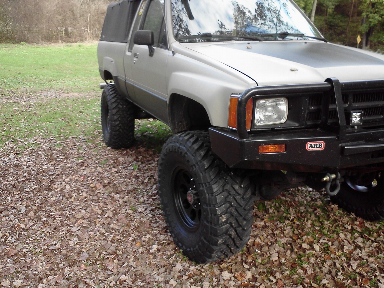

Got new shoes today. 315/75R16 Toyo Open Country MT on 16x8 MT Classic III Black. These Toyos are awesome! Tire shop talked me into balance beads and I agreed since I didn't want sticky weights. They work great. No vibrations at any speed up to 80mph. They aren't just air soft beads or BBs, they're made for internal balancing.
As far as noise, they are quiet up to about 45mph, after that they "whir" a bit. About the same as the BFG KM2s. I still hear radio and exhaust over tires easily.
